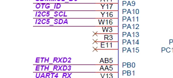

Thanks for your answer.
Through your answers, I learned the function of the PA13 and PA14.
​But there is something I can't understand.
There is no connection of PA13 to PA14 in the schematic of my board.0693W000006Ggn1QAC.png​

AntonioST
Jan 4, 2021 9:37 AM UTC
If you only remove the line
st,fastboot-gpios = <&gpioa 13 GPIO_ACTIVE_LOW>;
without disabling CONFIG_FASTBOOT you should get an error at boot time.
The option CONFIG_FASTBOOT is activated automatically by the option CONFIG_USB_FUNCTION_FASTBOOT that is in U-Boot default configuration files '<u-boot>/configs/stm32mp15_*_defconfig' and/or in the patches applied to U-Boot by yocto layers.
Disabling CONFIG_USB_FUNCTION_FASTBOOT should fix the issue.
The fact that you have 'interference' from ethernet cable on 'floating' PA13 could be explained with board noise; probably your device tree doesn't set any pull-up to PA13, so it get sensitive to some noise on the board.
