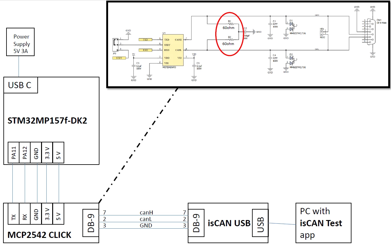

I would like to use CAN communication on my devboard : STM32MP157f-DK2.
So I prepared OS, unfortunatelly I have to flash STM32MP157c-DK2 version according with problem described below:
Faulty boards out of the box
So, after run OS, I edited *.dts file, by initialized &m_can1 device on PA11 and PA12 pins, which one exposed  on the board connector - CN2, and connected "MCP2542 click CAN bus transceiver" board.
In OpenSTlinux userspace I try recive CAN frames by command: candump can0, and there is any problem, because when I send full frame with 8 bytes that it doesn't arrive to device. Maksimum only 5 bytes in frame arrives, like below:
What can be wrong with CAN in STM ?
Please for any tips.

ienecodeAuthor
Feb 4, 2025 10:11 AM UTC
I do not use 120 ohm resistor because twice 60 ohm are included in transceiver MCP2542 Click. - please look on the below schematic:

mƎALLEm
Feb 4, 2025 11:40 AM UTC
if you can let me intervene even I'm not MPU products expert.
From your first post, you shared a figure where the frame sent by your host contains 5 bytes and are received well by the MP157. Which is expected. But STM32MP1 has FDCAN interface supporting CAN-FD frames.
You didn't show the behavior where data length > 5 bytes.
Note that the data length with FDCAN can reach 64 bytes if you are using the peripheral in CANFD mode and the data length is included in the frame in the DLC field. So the application needs to read that field to extract the exact number of bytes received.
So the question here, how did you configure FDCAN from the MPU side? in CAN2.0 or in CANFD mode? from your transmitter screen shot I conclude you are sending data in CAN2.0 format. Are you sure you set FDCAN peripheral in Classical mode (CAN2.0)?

ienecodeAuthorBest answer
Feb 5, 2025 4:14 PM UTC
@mƎALLEm  Success , All frames arrived to STM32 from   ECU, and USB converter, when I set interface like below:
ip link set can0 up type can bitrate 500000 sample-point 0.750
But I do not know why...
