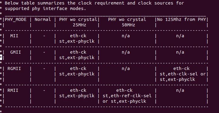

I checked this and it seems that SYSCFG ETH_REF_CLK_SEL bit is set, so MAC is really clocked wrongly.
I digged in the linux driver (https://github.com/STMicroelectronics/linux/blob/v5.10-stm32mp/drivers/net/ethernet/stmicro/stmmac/dwmac-stm32.c) and discovered that in stm32mp1_set_mode() function it always sets this bit with enabling clock.
So using 25 MHz mode without crystal is impossible at all:
case PHY_INTERFACE_MODE_RMII:
	val = SYSCFG_PMCR_ETH_SEL_RMII;
	if ((clk_rate == ETH_CK_F_25M || clk_rate == ETH_CK_F_50M) &&
		(dwmac->eth_ref_clk_sel_reg || dwmac->ext_phyclk)) {
		dwmac->enable_eth_ck = true;
		val |= SYSCFG_PMCR_ETH_REF_CLK_SEL;
	pr_debug("SYSCFG init : PHY_INTERFACE_MODE_RMII\n");
	break;
I changed this to the following:
	if (clk_rate == ETH_CK_F_25M || clk_rate == ETH_CK_F_50M) {
		if (clk_rate == ETH_CK_F_50M &&
	break;
And now it finally works fine in 25 MHz mode, and I can see clock on PCB.
I don't really get the meaning of "st,ext-phyclk" so my patch may be wrong. But the current driver definitely seems buggy. I didn't checked U-Boot but there also may be similar bugs.
As I understand, in the master of the ST Linux repository this driver is reworked, so it may be not the issue in future releases.
	break;
	break;

Indeed you've just found a bug in the dwmac-stm32.c driver DV3.0 version. And you are right in the next versions (DV3.1 +) the "st,ext-phyclk" will be removed for the 25MHz no crystal configuration. Your patch is correct, I will report that as bug for correction on the DV3.0 version.
Thank you for this thread of messages and for your contribution in solving this issue.
