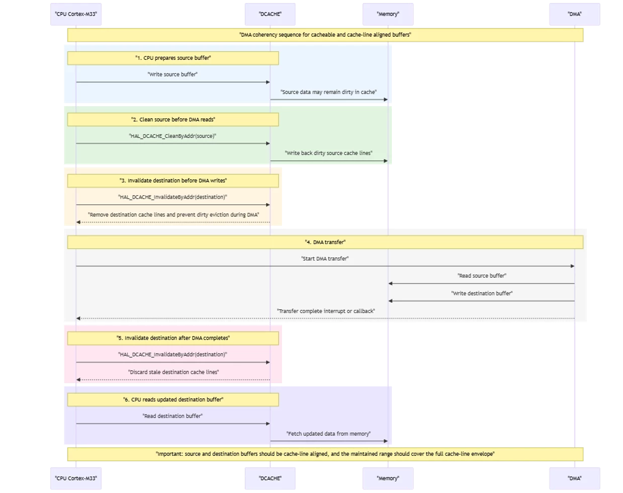

In a memory-to-memory DMA example, this sequence means:
  • Clean the source buffer before DMA starts.
  • Invalidate the destination buffer before DMA starts.
  • Invalidate the destination buffer after DMA completes.
The following diagram summarizes the recommended DCACHE maintenance sequence for a DMA transfer using cacheable buffers on on STM32 devices.
Figure 1. Recommended DCACHE maintenance sequence for DMA coherency.

  • Using DMA buffers that are not aligned to cache-line boundaries.
Conclusion
On STM32 devices, DCACHE coherency for DMA follows a simple policy:
  • Buffers in non-cacheable regions do not require DCACHE maintenance.
  • Buffers in cacheable regions require explicit clean or invalidate operations.
For information about how to enable and disable caches on STM32MP2xx CM33, refer to the ST wiki:
ST wiki: How to add ICACHE and DCACHE support to your applications

The article has generally good recommendations and explanations but there are some additional hard-won nuggets that can help to avoid some pretty miserable debugging experiences.  Got the scars...
Under “3. DMA transfer” above I believe there should be an invalidate step prior to starting an inbound DMA.  Without this it’s possible that a (dirty) cache line falling in the DMA buffer could be evicted during the DMA, possibly overwriting DMA-written data.  The invalidate following the completion of the DMA (4) is still necessary to ensure that all cache lines are in their proper state before the CPU attempts to read any data (5).
Also, the OP doesn’t mention the importance of cache-line alignment of the DMA buffers (both outbound and inbound) to avoid even more subtle problems related to the fact that the cache operations operation on complete lines, not bytes within a line.  (I also advocate sizing DMA buffer envelopes to a cache-line boundary in addition to the alignment criteria (for the same reason).  Some disagree with the need for the sizing criteria and I’m sure they’ll be along shortly...)
shivam203Author
Aug 11, 2026 7:36 AM UTC
Hi ​@David Littell ,
Thank you for reading my article and giving the feedback. You are correct: for a cacheable DMA destination buffer, an invalidate should also be performed before starting the DMA transfer, not only after completion. For the second part, I purposely not mentioned the cache alignment because it is more of a generic part for any buffer which is cacheable to be aligned whether we are talking about cache maintenance or not. It is a very important step for good cache maintenance. So, I updated the article on cache-line alignment as well.
Since cache maintenance operations apply to whole cache lines, DMA buffers should be cache-line aligned, and the maintained range should cover the full cache-line envelope of the buffer to avoid affecting adjacent unrelated data sharing the same cache line.

One more step for completeness: beyond the DMA data buffers themselves it might be helpful to discuss the more-sophisticated in-memory DMA-referenced control structures (e.g.,  linked lists) in the same light.  Because DMA references those types of structures just as it does outbound data buffers they should be handled in a similar fashion (cache line flushing, alignment, and sizing), yes?  And if the in-memory DMA control structures are updated by DMA as they’re processed (completion status, etc.) the invalidate-before-read pops up again.
