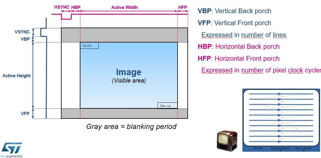

To display a picture each second, the display expects some blanking period with virtual pixels (no real pixels, called vertical and horizontal 'porch' in the figure below). Periods with active pixels correspond to the pixels of the image transmitted. Generally, the banking periods last 40% of a frame period. This depends on the panel, and can be shorter.

The maximum display resolution for RGB888 pixels is such:
Display pixel width X display nb of lines X fps X 1.4  <= maximum STM32MP1 pixel clock, that is, 90 MHz.
For example, a display with the resolution 1366 x 768 @ 60 fps needs a pixel clock 1366*768*60*1.4 = 88 MHz display. 1280 x 800 @ 60 fps needs to 86 MHz, is also fine.
One can support higher resolution by reducing the display refresh rate or the display blanking period (tolerance depending on display).
One can support various display pixels width/display nb of lines without any issue.
