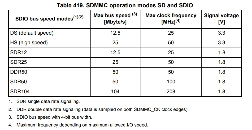

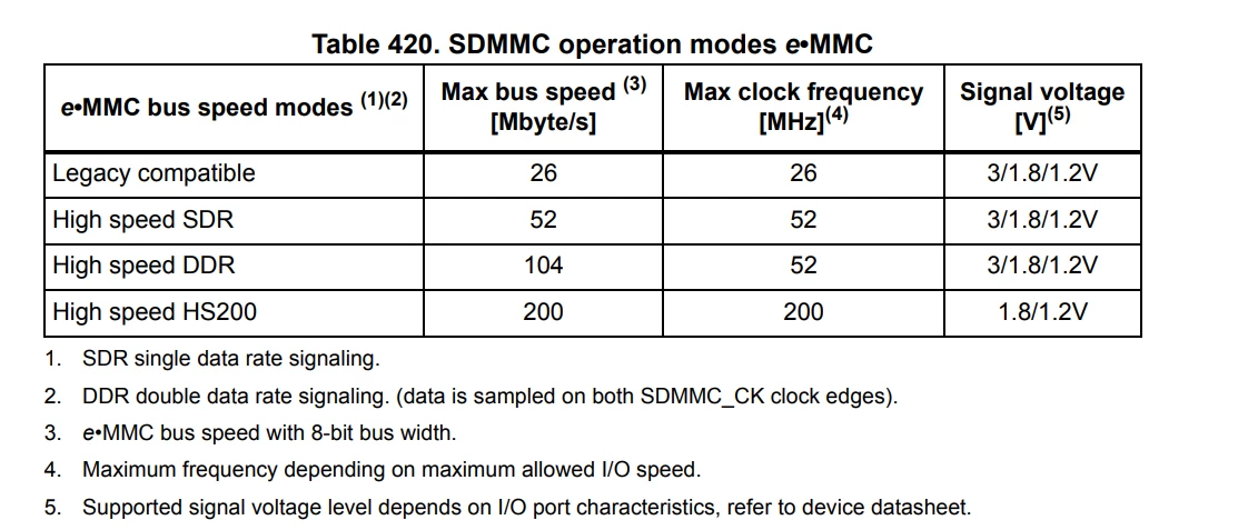

The SMMDC mode is set according to the flash device and the expected speed. Not all modes are supported by hardware. For example, HS400 is not supported on eMMC.
The driver modes are defined in the device tree file linux/Documentation/devicetree/bindings/mmc/mmc-controller.yaml in v6.6-stm32mp of STMicroelectronics/linux.
The maximum frequency of SDMMC_CK is given in the tables of RM0436 Rev 7, SDMMC operation modes. This value is a maximum. For example, in "eMMC High speed DDR" mode, SDMMC_CK can use any frequency from 0 to 52 MHz.
In STM32MP1 RefMan0436, the tables indicate that HS200 supports a maximum clock of 200 MHz, as defined in the JEDEC standard.
But on STM32MP1, the maximum SDMMC_CK frequency for eMMC and SD card is 100 MHz, not 130 MHz.
The I/O maximum speed is the limiting factor.
