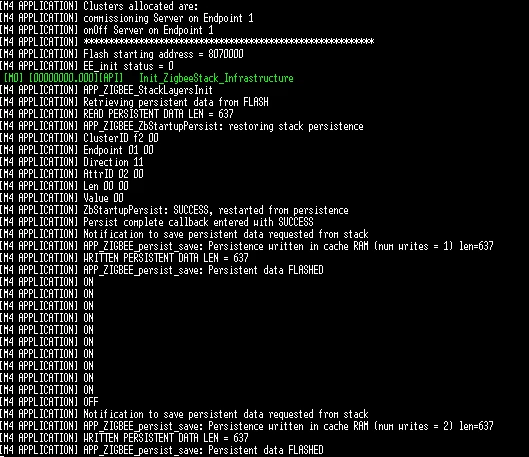

I read the AN5492 and the Zigbee_OnOff_Router_NVM example. My current code is globally a copy/paste of the Zigbee_OnOff_Router_NVM example with one GPIO control in the On/Off callback. The clusters I'm using are Commissioning (Server) and On/Off (Server), both on the same endpoint. While I can still join my network if the NVM is cleared from any Zigbee-related value, once the connection is successful, if I reboot the device, the STM32 can successfuly connect but is only controlable via Zigbee for a short time: Especially between two persistency callback call (see below):
As you can see on this picture, the Zigbee commands On/Off are successful between the two notifications but once the second on is called, it stops responding to any command...

Hi @HardWins,
In your app_zigbee.c file I don't see the part related to the persistence management, is it the right file ?
Can you describe the status of your network after the second call of persistence callback ? Have you been able to debug and see if there is any hard-fault making the communication not possible ? Need some additional information here.

Actually, I don't understand why there is this second call... As far as I understand, the first one is caused by the ZbStartupPersist ending with SUCCESS (as described in the ZbStartupPersist function -- zigbee_core_wb.c) but the second one, I can't understand for now.

Thanks for the updated file.
My question was directed on the software part to know if the device is still active on the network or if there is any leave performed.
The notification callback is called each time a persistent data change occurs in the Zigbee network, a wireshark capture will be appreciated to further analyze.
Have you been able to make a breakpoint after this second callback to know if the program is blocked somewhere ?

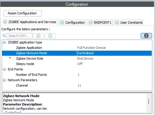

My device is defined as an "end device" but sleepy mode is "off". I tried with Device Role equal to "router" but the issue is still present.
Nevertheless, knowing that the device goes into sleep mode is a good track. How do you see that ? I also tried to switch from "centralized" to "distributed" but the issue is still there.
Thank you
Sep 30, 2024 1:10 PM UTC
The device remains sleepy even when disabling the sleep mode on CubeMX, we are working on this issue and it will be solved in next release.

Thank you for the updated file. I still have the issue even with the endDeviceTimeout set to 0xFF. Also, the second callback appears ~10s after the first one if this can help to identify the issue.
