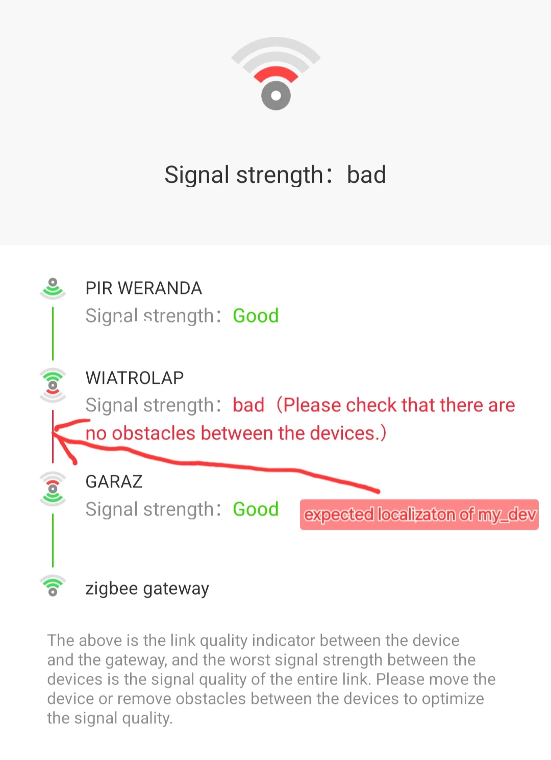

Hi. I`m using Zigbee_OnOff_Router_NVM example on WB55CGU6 custom board with existing Zigbee network in my home, but seems that my device not act as router. I mean that it not extends range of my network. What i do wrong?

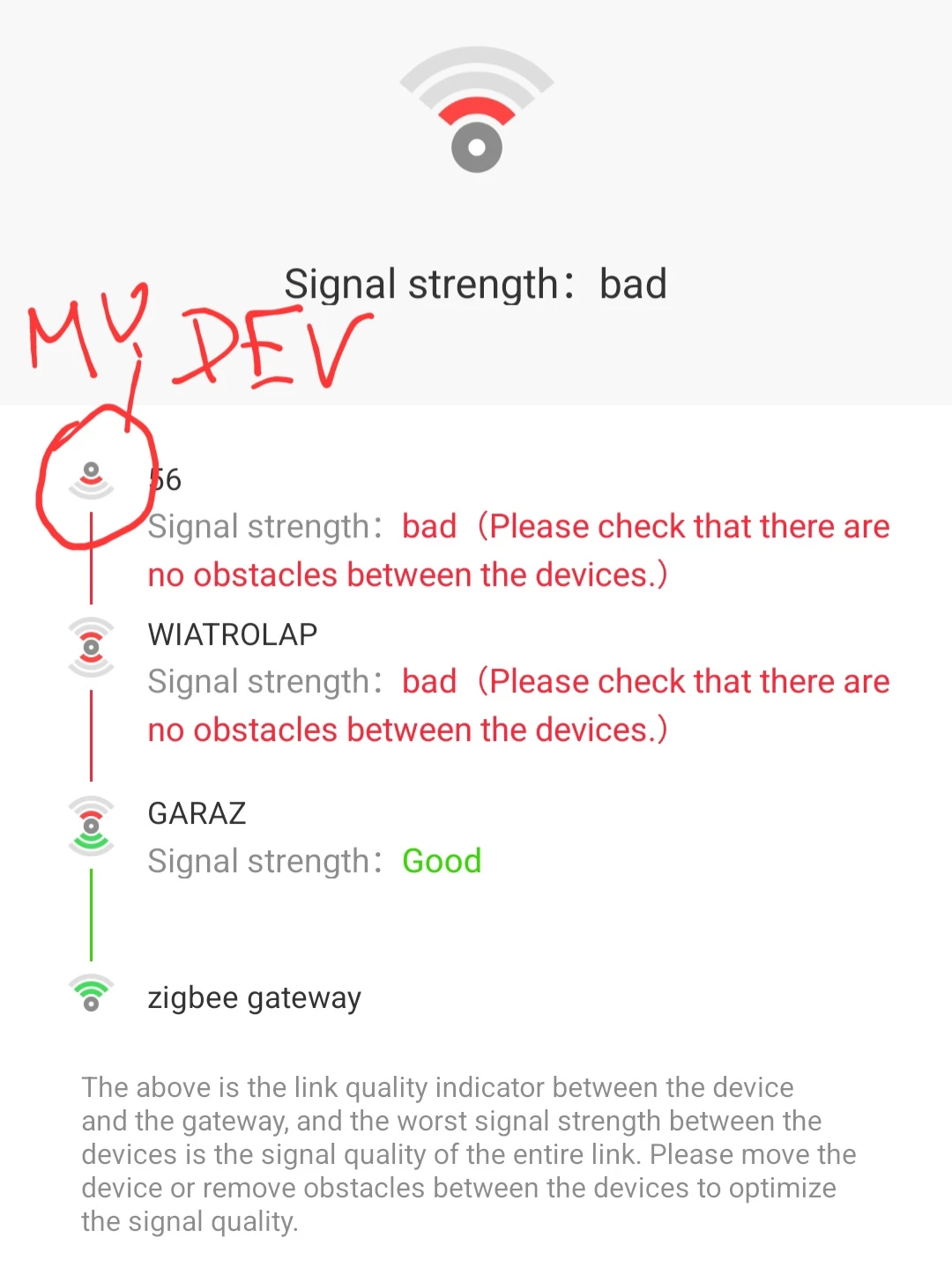

Thank you for your response, @STTwo-32. I agree that the application is working correctly and I have no errors. I posted the logs for informational purposes. As I mentioned earlier, my problem is that I cannot confirm that my device is functioning as a router in my home Zigbee network.
The image on the right shows the actual situation, where My_Dev is physically located roughly halfway between "WIATROLAP" and "GARAZ", but it is not visible in the Tuya app. Therefore, I conclude that it is not functioning as a router.
 Thanks for support.
