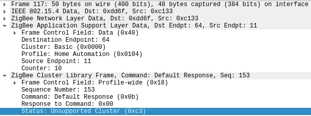

I am working with the STM32WB55 Nucleo board to create a Zigbee device being able to connect to a Philips Hue Bridge v2.1. Using a 2.4GHz sniffer with wireshark I am able to follow the communication which goes through the following steps with no problems:
  • Beacon
  • Association request + response
  • Transport key exchange
  • Node descriptor request + response
  • Endpoint descriptor request + response
  • Simple descriptor + response
Where it fails is the coordinator (hue bridge) sends a Read attributes on the Basic cluster (0x0000) to the STM32. It responds with a ZCL Default response where status says "unsupported cluster (0xc3)".

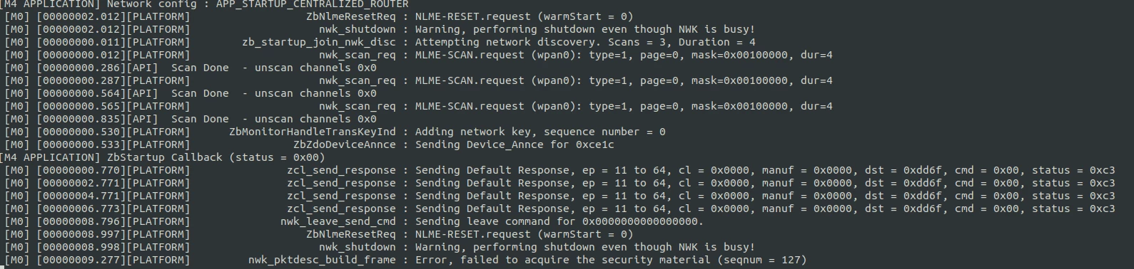

0693W00000DqEUpQAN.pngAnd the trace output from the STM32WB55 reports that it sends this default response, but I would expect it to be responding with the Basic attributes configured.
0693W00000DqEVxQAN.pngThe code is based on the Zigbee_OnOff_Client_Router example modified to be a ZCL_DEVICE_COLOR_DIMMABLE_LIGHT server.

Is there any explanation for why the Zigbee stack does not respond to the basic cluster read attributes request?

The basic cluster is mapped by default on each endpoint.
It would be interesting to know what are the active endpoints on the STM32WB.
If the Read Attribute is sent to an endpoint that does not exists or reserved (Green power), this behavior may happen.
