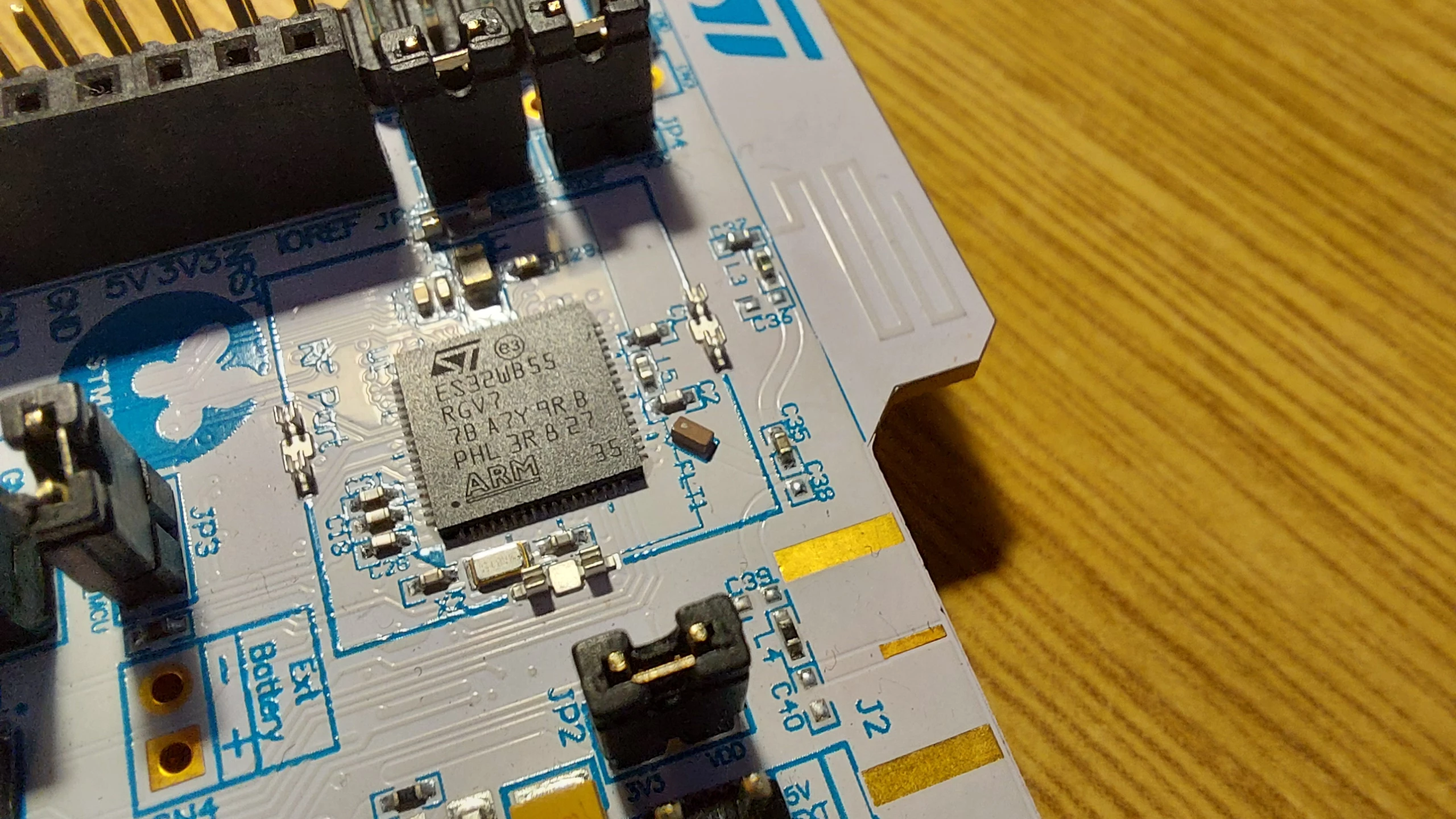

Zigbee: ip802154_lld_exitSleep() FAILED
testing Zigbee_OnOff_Client_SED on P-NUCLEO-WB55. Sources are from version 1.18.0, same as installed stm32wb5x_Zigbee_FFD_fw.bin. Almost no changes to source files except modification channelmask to WPAN_CHANNELMASK_2400MHZ.
After a while (random inteval) device send following debug message, and device can't find network anymore:
[M0] [00007009.694][LLD] !! ip802154_lld_exitSleep() FAILED : LLD state before 2 - time before 2714719056 - sleepTimeStatus 1 - wakeUpStatus 149 - default state after 99 (1) - LLD state after 2
Does anybody have a clue? Any suggestion?
Thanks.

Actually the nucleo board you are using is among the first development based on the ES32WB55 which is a very early sample of STM32WB product not fully validated and may have some issues corrected in the final STM32WB devices delivered on the market.
I recommend highly to acquire the latest version of the nucleo board that may resolve your issue, if not, a sniffer logs would be appreciated to analyze the radio environment as I'm not able to reproduce the issue with a WB55 coordinator.

With RFD seems to me that error happen more often, and earlier after power up. Also seems kind of temperature dependent. But i have no relevant data. Could it be problem of first silicon version? After shield remove i found my Nucleo-WB55 is one from the first pieces populated with ES32WB55.

thanks you for your help. I'll buy new nucleo. I should check version of the device earlier. For now we can close this case. Again, thank you.
