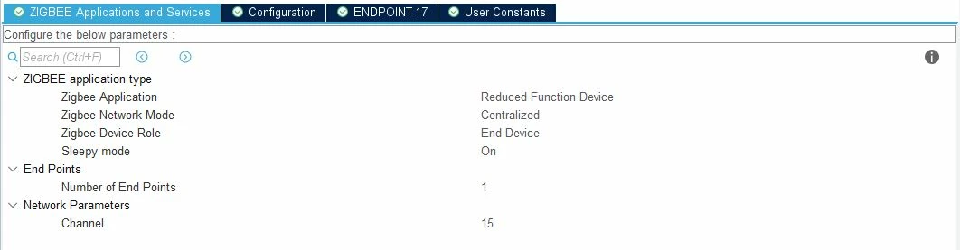

Please find below my answers to your questions :
1- We have raised an internal ticket 187674 to analyze the case where the reporting does not work with a data length >= 82 , we will reach out to you asap.
2-  To configure a Zigbee device as SED, you have to make sure first that your device is flashed with the M0 binary  stm32wb5x_Zigbee_RFD_fw.bin and to enable the flag CFG_LPM_SUPPORTED, if this is the case, please share the logs and wireshark capture to further analyze.

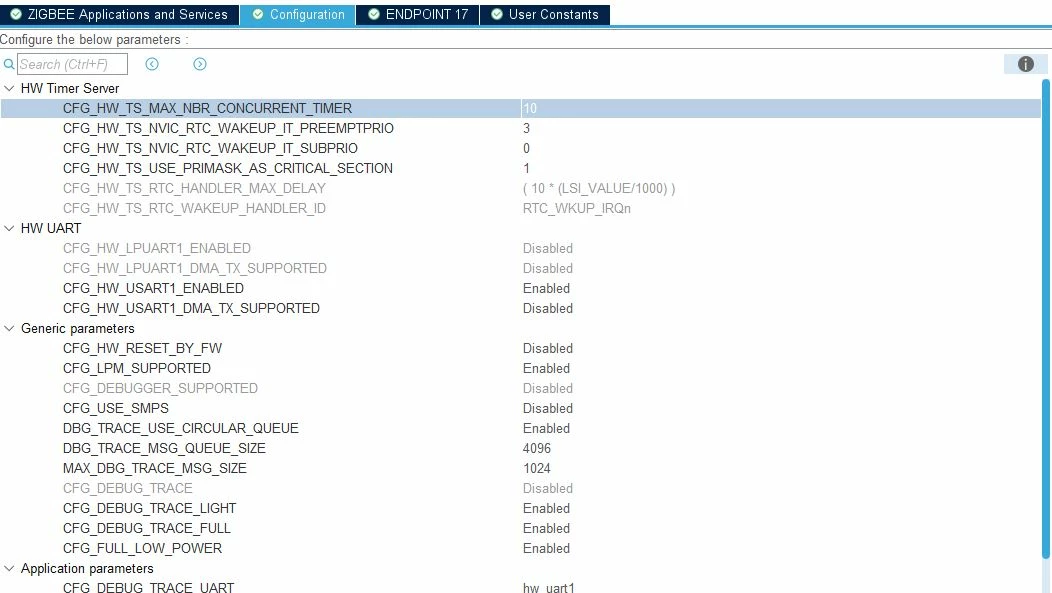

thanks for the help.
2- I uploaded the M0 binary stm32wb5x_Zigbee_RFD_fw.bin, enabled sleepy mode and and to enabled the flag CFG_LPM_SUPPORTED. Unfortunately also the logging does not work. This is my current configuration:
Best regards

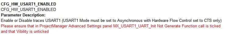

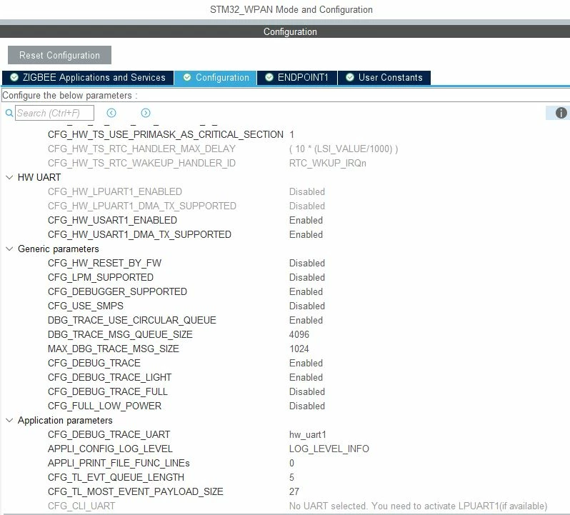

Aug 12, 2024 1:06 PM UTC
The debug trace feature is disabled by default with the flag ( CFG_DBG_TRACE )  for applications that needs to activate the full low power mode, you may enable it manually on your code => CFG_DBG_TRACE with the desired level ( only for debug).
Best regards,
Ouadi

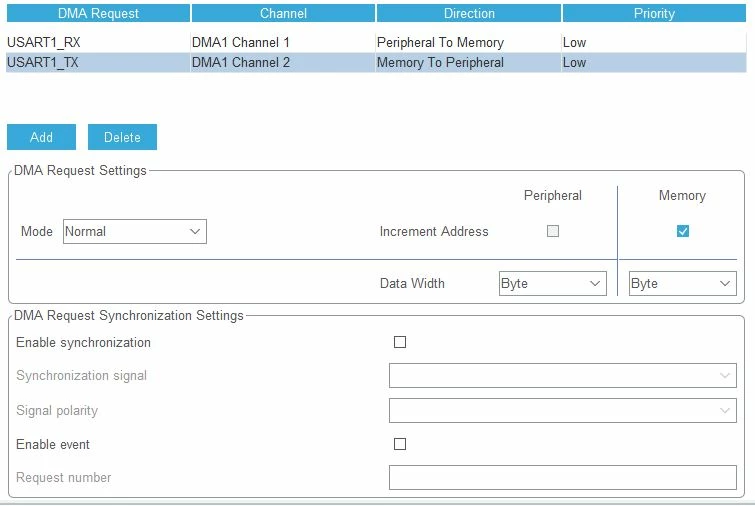

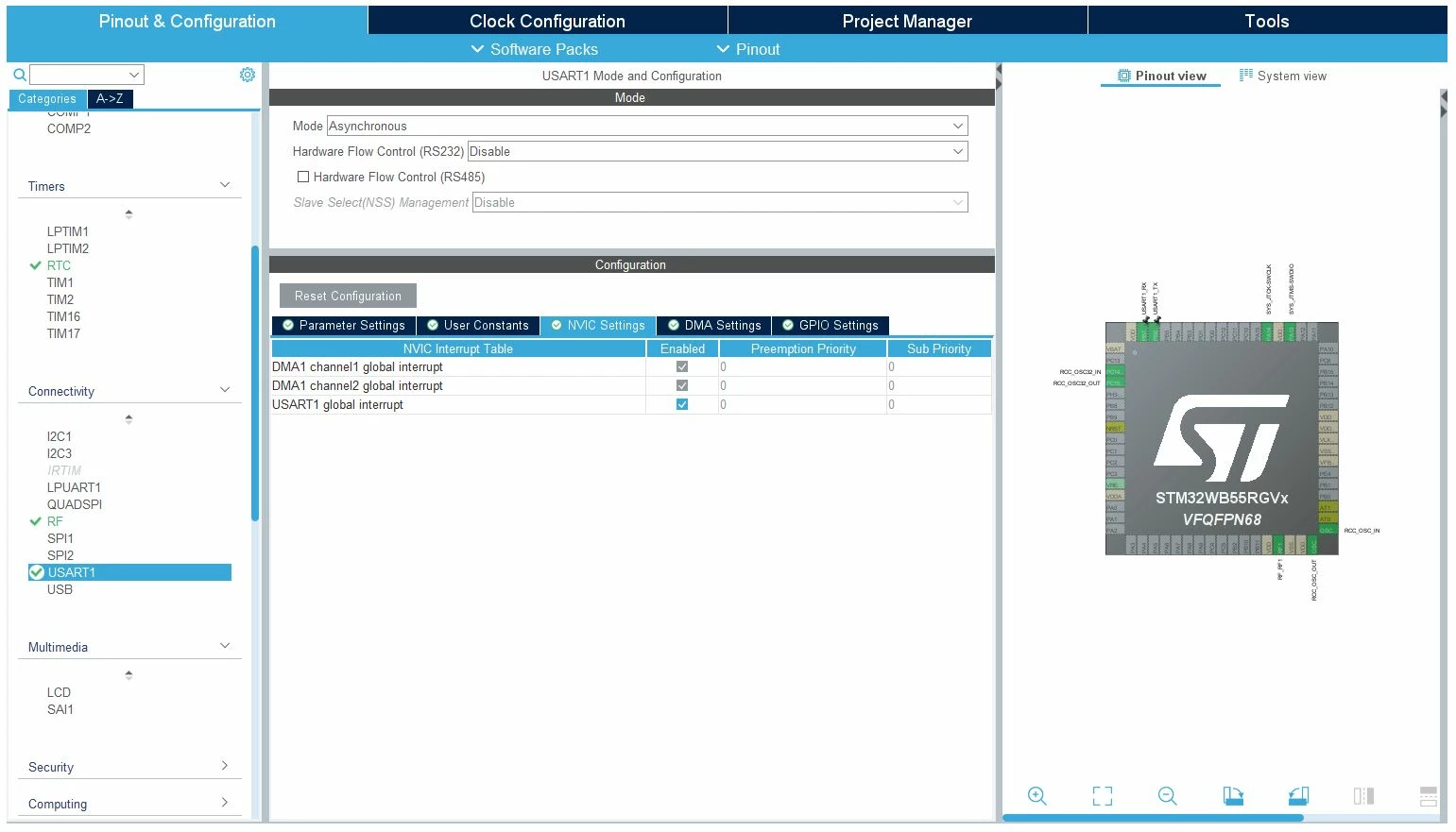

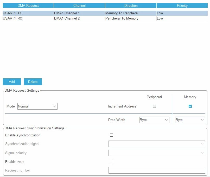

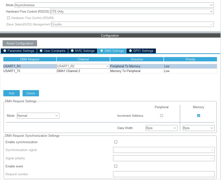

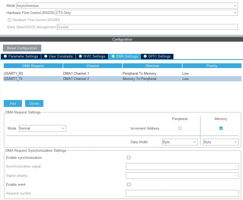

Aug 12, 2024 3:35 PM UTC
Could you please share your UART configuration and DMA settings ?
You need to make sure that DMA is activated as the DbgOutputTraces function uses the DMA to transmit data.
Regards,
Ouadi
NameAuthor
Aug 12, 2024 3:45 PM UTC
I followed the instructions given in the configuration interface.
Best regards

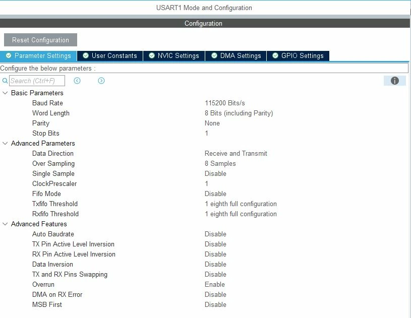

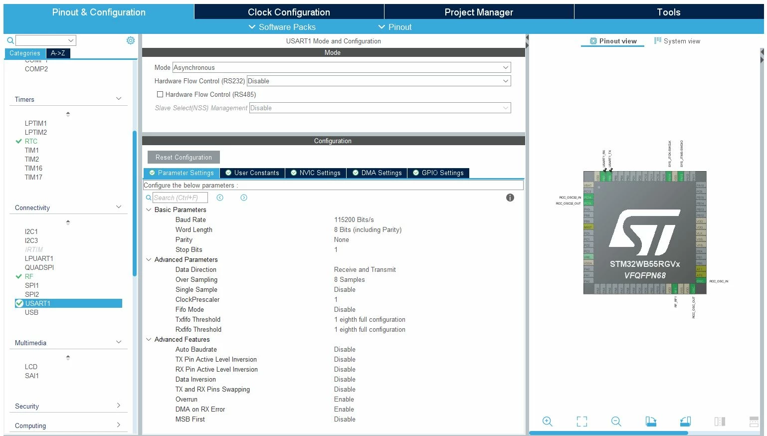

Aug 12, 2024 4:00 PM UTC
Looking at your settings you have to disable the Hardware flow control RTS/CTS which is only used for RS232 communication.
Best regards,
Ouadi

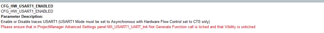

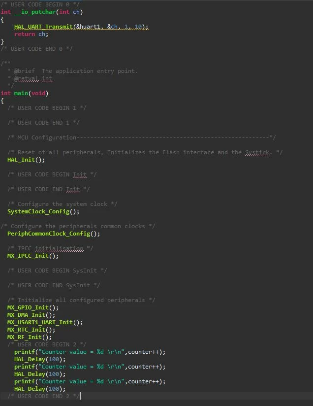

NameAuthor
Aug 19, 2024 12:44 PM UTC
Hey,
I got my hands on a Nucleo STM32WB55RGV6 MCU and tried to get a simple example with activated Zigbee and Log to run. USART1 is working fine via the debugger as long, as Zigbee is not activated in CubeMX. I tried switching on and off the recommended paramters from CFG_HW_USART1_ENABLED, but no output at all. Deactivating Zigbee results in the USART working fine again.
My configuration and (simple) code is appended below:
Best regards
Aug 19, 2024 1:01 PM UTC
Please make sure to set the right settings on Zigbee CubeMX configurator, as an example you can have a look on the different examples activating Zigbee on our ST Github
Also, you have to flash your device with Zigbee M0 binary to be able to run zigbee stack.
Regards,
Ouadi
NameAuthor
Aug 19, 2024 1:33 PM UTC
Hey Ouadi,
Newest RFD Zigbee stack is flashed. I copied the settings from the Zigbee_OnOff_Client_SED example, including all pinout&config, clock, project manager. No output on the serial. I also tried uploading the example project directly, which gives compilation errors on two different machines (fresh cloned repository).
Best regards
Aug 19, 2024 3:34 PM UTC
Zigbee SED application uses the Full Low Power mode with CFG_DEBUG_TRACE disabled by default as mentioned previously to save the consumption, You have to enable this setting to be able to activate the trace.
Kind regards,
Ouadi

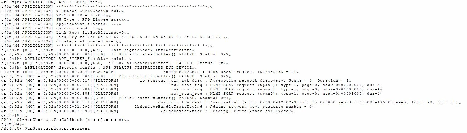

Sep 17, 2024 10:17 AM UTC
Hello Ouadi,
I solved to enable the traces on the sleepy end device (as mentioned in my other post) and now want to go back to the original problem of the sleepy end device not waking up after connection to the coordinator.
I appended the log below.
Best regards
Sep 18, 2024 9:20 AM UTC
Nice to hear that you were able to solve the traces.
Now for the LPM mode, I assume that there is something wrong on your application avoiding the device to wake up from sleep mode.
I recommend to look at the example Zigbee_OnOff_Client_SED  where the sleep mode is activated and the device wakes up periodically with no issues.
Regards,
Ouadi

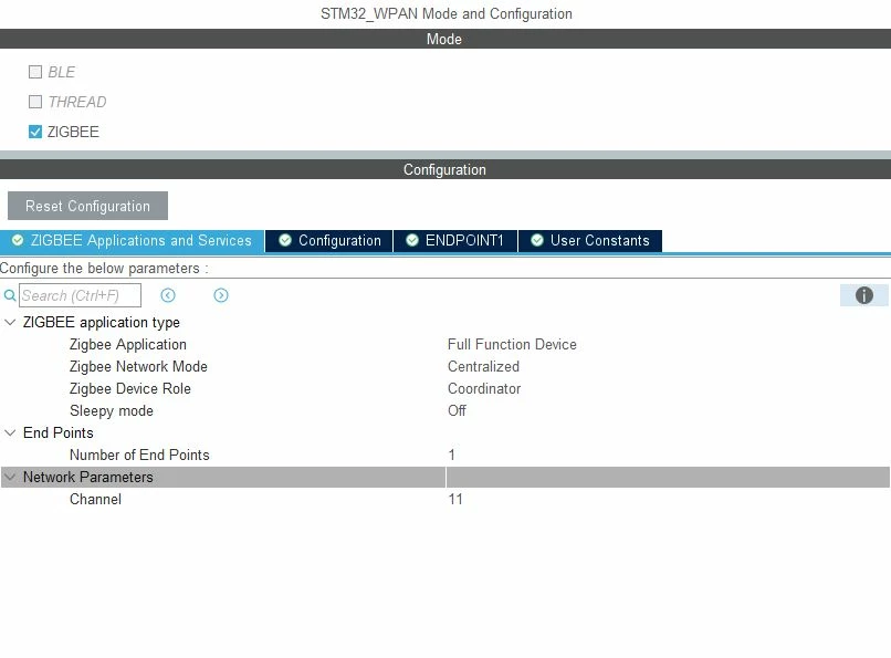

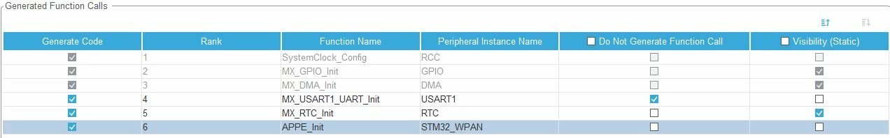

Aug 26, 2024 10:48 AM UTC
Hello Ouadi,
I found a possibility to read the serial output from the micromod development board.
I started with a fresh project to eliminate possible errors or incompatibilities from the old project.
First, I set up only the standard USART1 output on STM32WB5MMGHx PA9 and PA10. Serial output works as expected in this simple setup.
Now, I want to continue as simple as possible to get the debug traces to work when running Zigbee. For this, I set up the device to work as coordinator/reduced function device, with all settings left to standard (no sleep mode), except the ones to get the debug traces to work. The projects builds without errors or warnings. Result: no output at all, despite the serial working before.
I appended my configuration here:
I appreciate any help!
Best reagards
NameAuthor
Sep 9, 2024 10:01 AM UTC
Hello Ouadi,
I tried changing Advanced Settings in Project Manager without success. What could be the issue of traces not being working here?
Thanks and best regards
