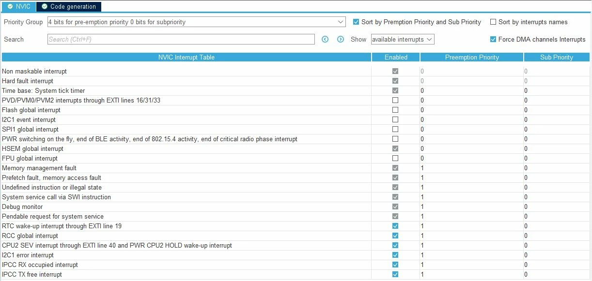

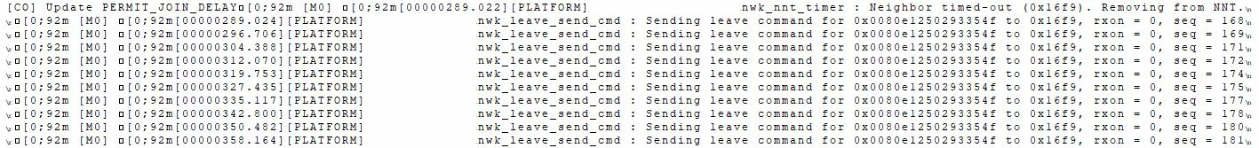

im developing a zigbee sleepy end device. The device is supposed to periodically send sensor values (max length of 512bytes) read via I2C to the coordinator using the custom cluster. I use the HW_TS to trigger the sensor readings and sending the message. After a few messages (~8-20) the sleepy end device messages start to not arrive in time or at all and out of order, ending with the end device hanging up and being removed from the network by the coordinator.

  • Playing around with interrupt priorities, especially sysTick Timer set to highest prioity. My current setup:
    I would appreciate any advice on what might cause this issue or what else I could try to avoid wrongly timed/garbled messages from the SEDs!

Hi @user5,
From the logs attached, it seems that the device is removed from the network by the parent as it is no more active ( no keepalive messages),
From my understanding, the sensor values read from I2C are sent manually to the coordinator over ZigBee, in this case, the application should manage zb requests timing properly and make sure to wait for a response callback to avoid any unexpected behavior on the stack side.
Please note that the best approach for such application is to configure the attribute as a reportable with a defined period or only on change, this allows to manage timing and the sleep mode as well accurately.
