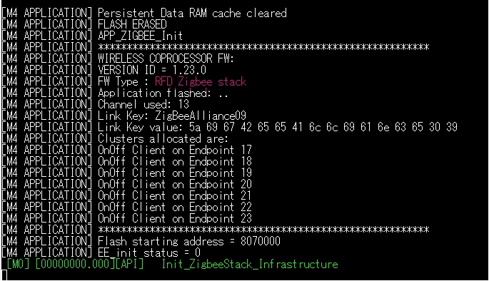

  1. Yes, you are right. Understand from the SED sample code readme.txt, in order to reached ultra low power consumption, it is needed to use RFD wireless stack on client side and hence the 2 lines of code to take effect. So I followed and flashed the RFD stack into our board. However, this action create another problem where the client cannot/fail to pair with the sever which use FFD wireless stack. As shown below debug picture. Any idea what is wrong? Any suggestion?

  1. Yes, I did it but doesn’t help. By the way, I manage to resolve the hang at “Init_ZigbeeStack_Infrastructure” mentioned in my earlier post. After I removed others 6 OnOff client clusters and it move on to do the pairing with the server (Dongle with FFD wireless stack). However, the server cannot receive and output the signal/data from the client router which I’m not sure why. Attached is the debug message  text file. Can you help to interpret the output messages and find out why the client OnOff router cannot transmit signal/data after paired with the server. Thanks.

Thank you for sharing the log file.
  1. At this stage, the logs do not appear to contain enough detailed information about the Zigbee communication flow itself. They mainly show the commissioning process, but they do not provide sufficient visibility into the actual transmission path for the OnOff client.
Could you please:
  • enable more detailed logs
  • set the logging level to ALL
  • share the relevant part of your Zigbee transmission implementation, especially where the OnOff command or data is sent
This would help us better understand whether the issue.
  1. Regarding Cube firmware v1.24, there were indeed some fixes and improvements in the Zigbee stack, but there does not appear to be any fix specifically targeting the OnOff cluster
Kind regards,
