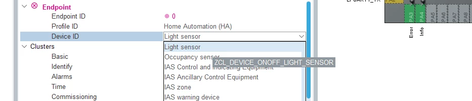

thank you for your explanations. So I configured my ZigBee stack to use three endpoints, but I can not find "ZCL_DEVICE_LIGHT_LEVEL_SENSOR" as Device ID in STM32CubeMX. Instead, I find this
Same for the other device IDs.
Or do I have to replace the selection from the STM32CubeMX UI with your example?

Hi @Kampi,
Actually the Device ID list configuration on CubeMX does not support all the device ID contained on the struct ZbZclDeviceIdT from the file zcl.enum.h, So you have to configure it manually in the code generated by CubeMX waiting for a new version with the DeviceID list updated.
Best regards
Ouadi
