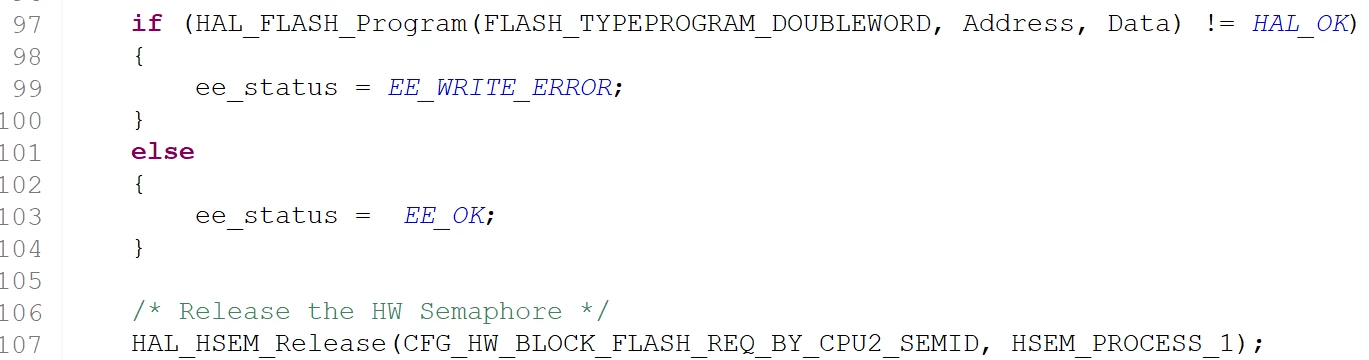

While attempting to identify an issue with reading and writing to emulated EEPROM, I have identified a bug in V7.0.0 of the X-CUBE-EEPROM source code.
This was identified in the STM32WB version of `flash_interface.c` with `DUALCORE_FLASH_SHARING` defined.
In the function `FI_WriteDoubleWord` on lines 97-104, the value of `ee_status` is correctly set to `EE_WRITE_ERROR` when a program failure occurs, however this is overwritten on line 104 with `EE_OK`.

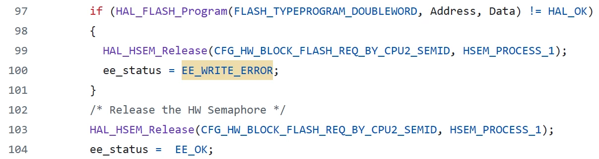

As a fix for this, I changed these lines to the following:
Could this be addressed in the next release of this tool?

Hi @Graham1 ,
Thank you for reporting it, much appreciated. we logged /escalated internally using this Reference #184454 for follow-up .
