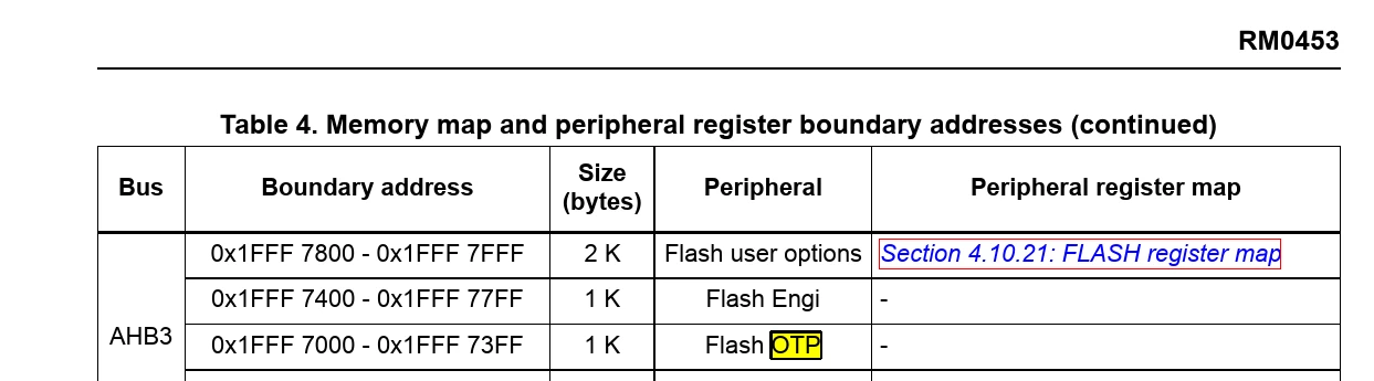

I want to write my own ID in the STM32WL55 memory. For this I use STM32Cubeprogram and the ST-LINK V3.
My question is: is there a small flash area where I can write this identifier and which does not interfere with the code and data so as not to be deleted.
I looked at the memory organization in the documentation but it's a bit confusing.

I don't know specifically for the WL55 chips, but there is usually an OTP section (one-time programmable) that is available, typically in the 0x1fff7xxx area (after the internal bootloader).  If you don't want to use that (or if it is too small), then any area of flash that is not used by your main program or in-circuit code updater.
AScha.3
Jul 22, 2024 6:10 PM UTC

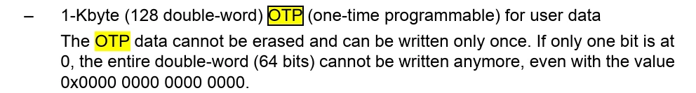

OTP area seems perfect for this, see rm:
Jul 22, 2024 7:01 PM UTC
You can also consider using the 96-bit unique ID (UID) or UID64 register to identify the chip, if that's the intention.
