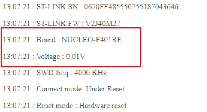

I reproduced the same behavior using ST-LINK FW : V3J10M3 and it works if I just put the option byte nBOOT0 to 0 before putting nBOOT1 and nSWBOOT0 to 0. Also, I suggest you to verify the Board that u are using and the voltage.  After the data you have provided, I think there is a problem in this two parameters as you can see in this capture.

You are correct to verify board,
but I am using cut-off ST-Link from F401RE board connected to own STM32WLxx PCB
(Outage of ST-LINKs in the past, so the need - produced that :) ).
Wiring and target voltage should be OK, considering everything is working normally on STM32WLE5:
