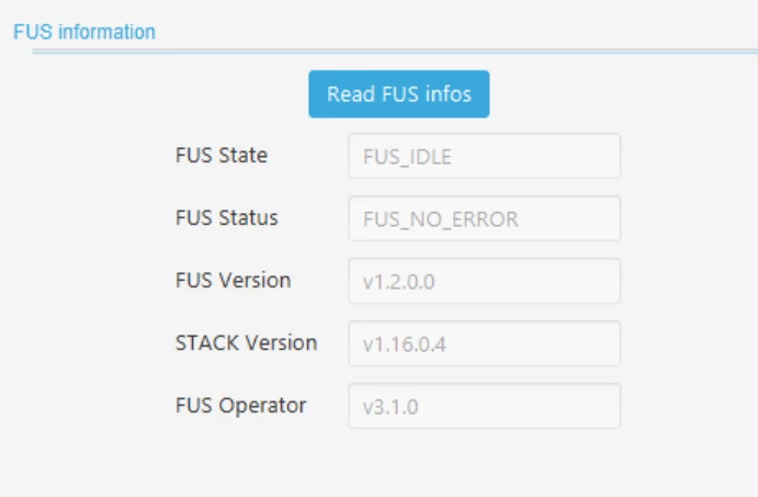

This is FUS information:
When I flash this project onto the device with STM32CubeIDE,
I am able to see and connect to the device with ST BLE Sensor app.

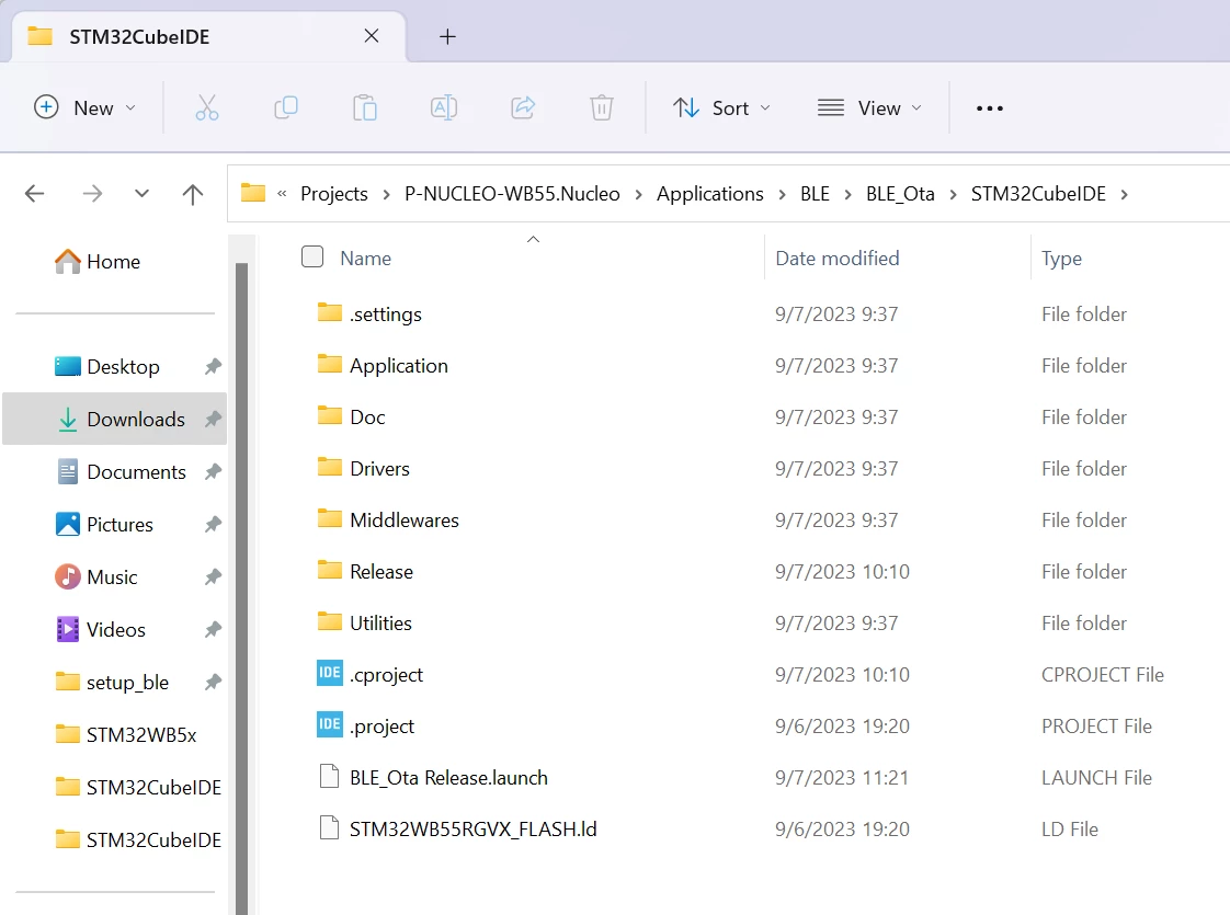

Once connected I press the Firmware Update button and try and flash the BLE_HeartRate_ota binary (that I got from opening the project in STM32CubeIDE and compiling it with binary output setting).

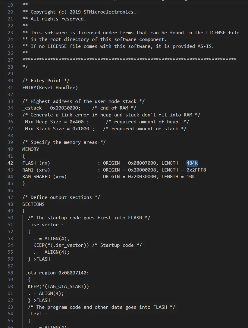

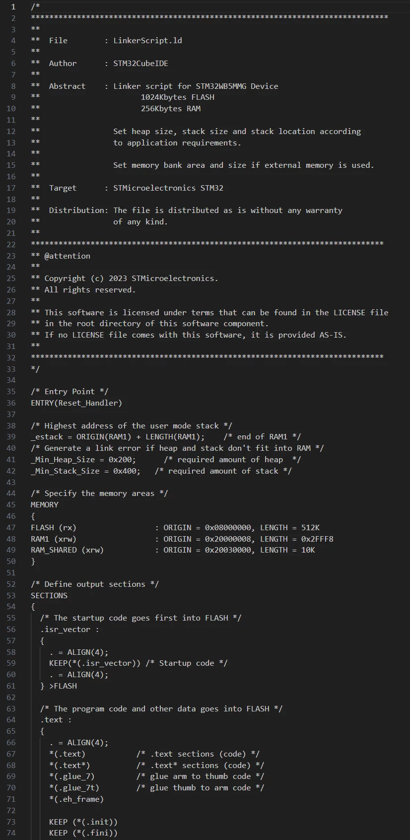

So what I did was to check the difference in the .id files of the HeartRate project and my project.
This is the STM32WB55RGVX_FLASH.id (working heartrate):
And this is is STM32WB5MMGHX_FLASH.id: (my project)
I did notice that in the working Hearrate, there is this line:
FLASH (rx) : ORIGIN = 0x08007000, LENGTH = 484k
but in my project I have this:
FLASH (rx) : ORIGIN = 0x08000000, LENGTH = 512K
So I started to suspect that my project has the wrong memory adress origin, so I changed it to the same as the heartrate but with no luck.
I also noticed this in the HeartRate example:
.ota_region 0x08007140:
KEEP(*(TAG_OTA_START))
. = ALIGN(4);
} >FLASH
which I did not have in my simple project, so I added that line too,
but still no luck.
