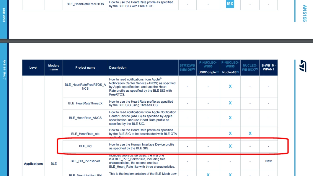

Andrew Neil
Jun 13, 2024 8:21 AM UTC
Yes, they all do Bluetooth Low Energy (BLE).
BLE can certainly be used for mouse & keyboard with computers.
Whether they can be used for TVs depends on what the TV supports.
EDIT:
Go to the Product Page for each board, and look on the 'Tools and Software' tab; eg,
https://www.st.com/en/evaluation-tools/nucleo-wb15cc.html#tools-software
There you will see an STM32Cube Package; eg, in this case, STM32CubeWB:
https://www.st.com/en/embedded-software/stm32cubewb.html#documentation
There you can see the Application Note AN5155 describes the available examples - HID is what you'd use for mouse, keyboard, etc:
