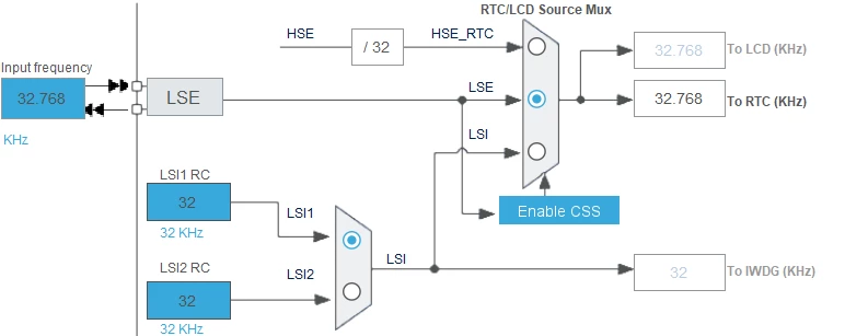

I'm using the internal RTC of the STM32WB55. When the MCU is running the RTC works normally : the calendar can be set and the time is running correctly. When i shut the MCU power down (but still have the VBAT up), and turn it up again, the calendar of the RTC is reset.
I have cleaned the init generated by cubeMX and tried to use a light initialization (NVIC and clocks) when the backup register flag is set but nothing worked:
static void MX_RTC_Init(void)
 hrtc.Instance = RTC;
 hrtc.Init.HourFormat = RTC_HOURFORMAT_24;
 hrtc.Init.AsynchPrediv = CFG_RTC_ASYNCH_PRESCALER;
 hrtc.Init.SynchPrediv = CFG_RTC_SYNCH_PRESCALER;
 hrtc.Init.OutPut = RTC_OUTPUT_DISABLE;
 hrtc.Init.OutPutPolarity = RTC_OUTPUT_POLARITY_HIGH;
 hrtc.Init.OutPutType = RTC_OUTPUT_TYPE_OPENDRAIN;
 hrtc.Init.OutPutRemap = RTC_OUTPUT_REMAP_NONE;
 if (HAL_RTC_Init(&hrtc) != HAL_OK)
 Error_Handler();
RTC config :
0693W00000UoMGpQAN.pngWhat should I have in my MX_RTC_Init() ?
Thanks,
Show.
Make sure there is no backup domain reset before that, e.g. related to LSE setup.
Or simply ditch Cube altogether and write your own program.​
JW​

I just did the same thing that HAL_RTC_MSpInit() does :
__HAL_RCC_RTC_ENABLE();
 __HAL_RCC_RTCAPB_CLK_ENABLE();
/* RTC interrupt Init */
HAL_NVIC_SetPriority(RTC_WKUP_IRQn, 0, 0);
HAL_NVIC_EnableIRQ(RTC_WKUP_IRQn);
HAL_NVIC_SetPriority(RTC_Alarm_IRQn, 0, 0);
HAL_NVIC_EnableIRQ(RTC_Alarm_IRQn);
