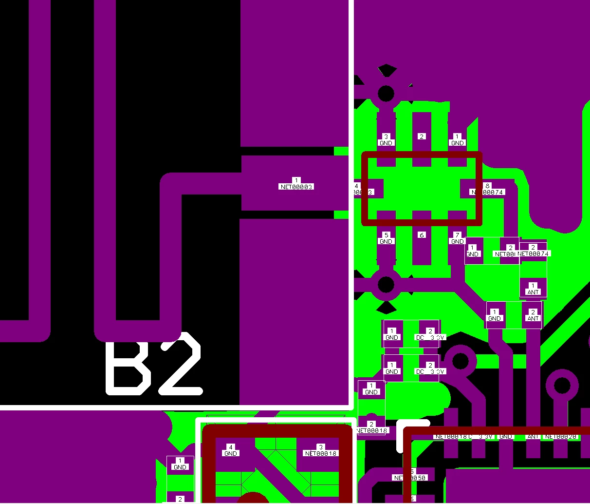

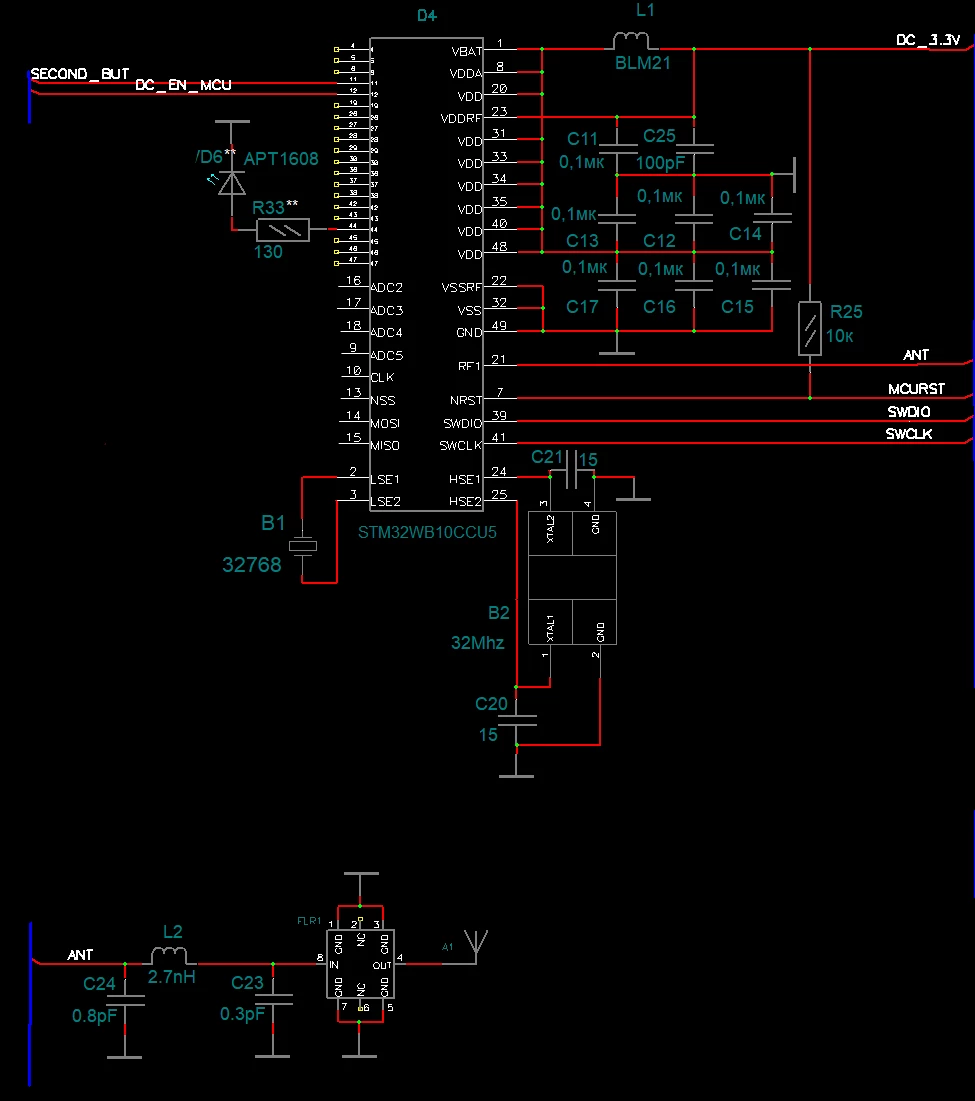

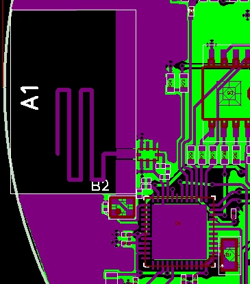

Why no Bluetooth signal and phone cannot connect to STM32WB10
There are some parts of the schematic and board view. I was created my own test project from video on YouTube from st.com. Also was tested stm32wb15 example projects with heart rate monitor which are worked.

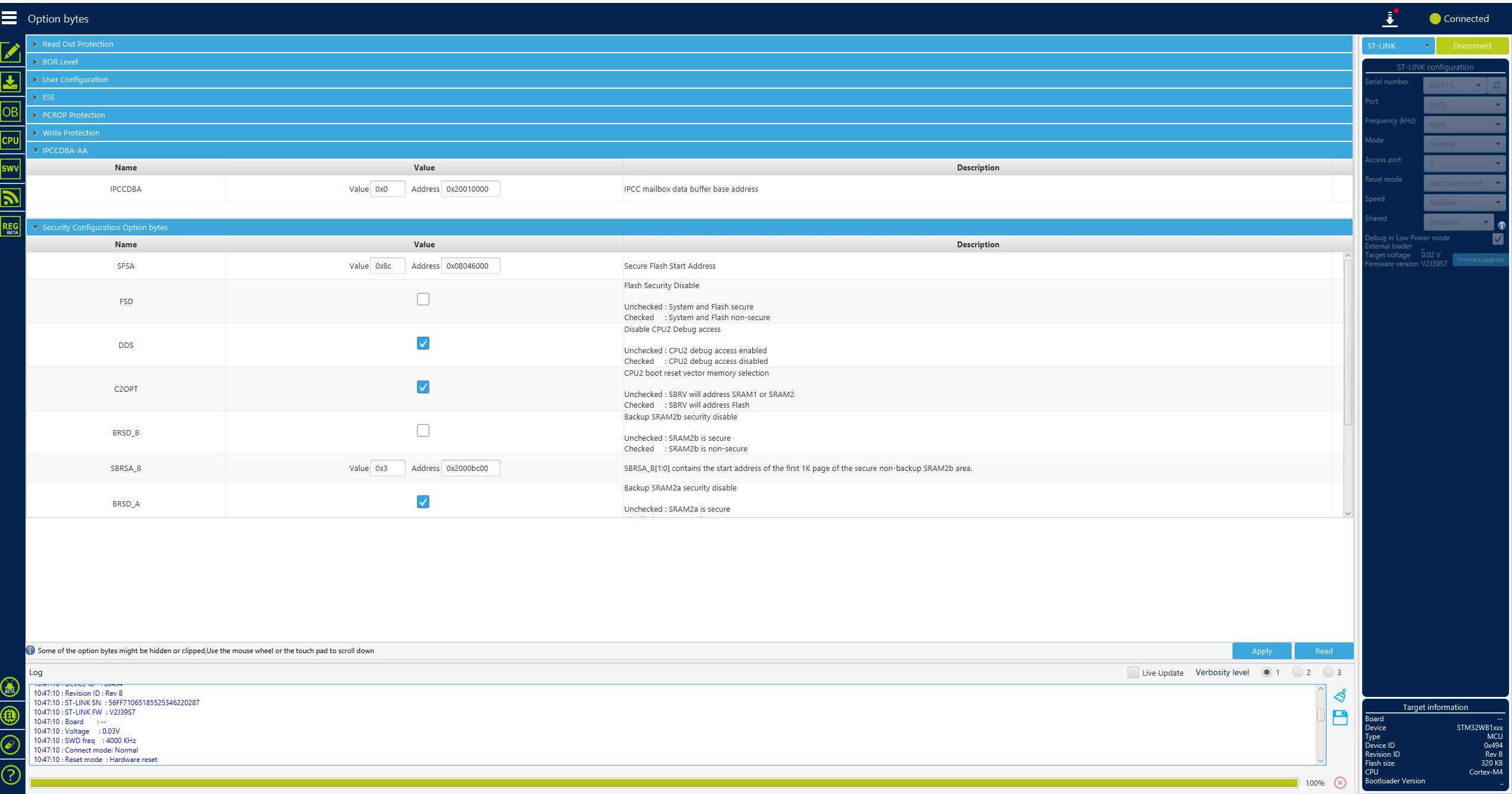

Also, my option bytes on screenshot
WIRELESS_FW_RUNNING іn stock
SHCI_C2_BLE_Init cause Error Handler with 0x01 code

UPD2: Solved.
Set correct option bytes for BOOT.
After CFG_HW_RESET_BY_FW set Disabled
