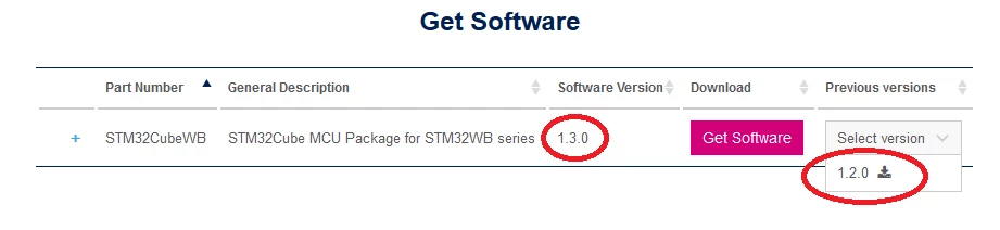

Why is the STM32CubeWB 1.3.0 package not available for download anymore? Is there a reason not to use 1.3.0? When will there be a full (usable) integration of the STM32WB in CubeMX or CubeIDE?

​Version 1.3.0 is the version by default when you click on the "Get Software" box, The can use a previous version clicking on the "Select version" box.
STM32WB is fully supported by CubeMX and CubeIDE. Note that CubeMX is now part of CubeIDE.

Thank you for the fast reply. I'm sorry, I misunderstood the concept of the Download page. I'm currently trying to setup a project using CubeIDE 1.1.0 with support package 1.3.0. I just don't get a setup where I get a runable/compilable project. Even if I use one of the ioc files from the examples, it just won't work. So far I was able to get the sample projects running but I want to start a clean project from scratch which supports the following:
