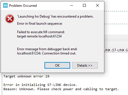

why do I get the following message when debugging? Target unknown error 19 Error in initializing ST-LINK device.
i'm using stm32wb30, and when i try to debug a empty program with ST-LINK/V2 and i get the following message:

Maybe that issue is linked to the ST-Link firmware version.
So, try to upgrade the ST-Link firmware version, then disconnect and connect your board.
Make sure to use the latest release of STM32CubeProgrammer and STM32CubeIDE.

Hi, I have installed stm32 cube programmer and when i use ST-LINK/V2 (I have update the st link ) doesn't work but i tried to use NUCLEO-F091RC -> ST-LINK/V2-1 for debug the stm32 and works perfectly. I can also debbug a program in cubeide.
Could it be that this version of st-link is not compatible with this MCU? i may need the ST-LINK/V2-ISOL.

What's the relationship between the NUCLEO and the ST-LINK/V2 here? You tried both separately.
The ST-LINK/V2 should be Ok, depends on the voltages, and that the VTarget needs to power the buffers within the ST-LINK/V2
