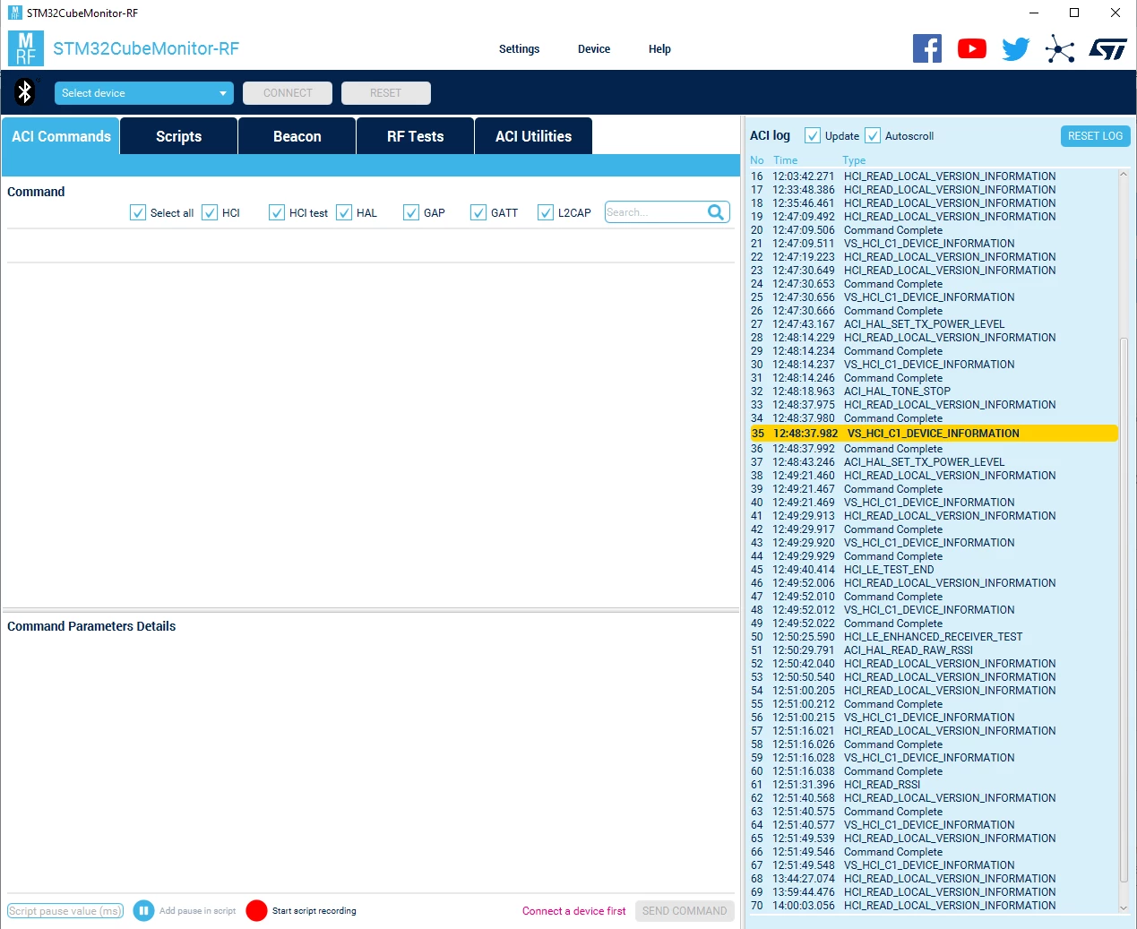

Why connection loss during send command to STM32WB55 MCU on STM32CubeMonitor-RF GUI?
I have a self-design STM32WB board and properly flash "stm32wb5x_FUS_fw.bin", "stm32wb5x_BLE_Stack_full_fw.bin" and "BLE_TransparentMode_reference.hex" STM32_Programmer_CLI.exe. Now I am trying to use STM32CubeMonitor-RF. When I try to connect to it sometimes I receive "Device under test not responding. COM port closed". However, sometime it is connected and after some other actions be disconnected. The ACI Log is as follows:0693W000006HY0mQAG.pngCan anyone help me to resolve this problem?

stephane.legargeant
Jan 11, 2021 8:18 AM UTC
In the screenshot, it seems that some command are sent, but there is no reply from the board. Line 52,53,54, the commands is repeated 3 time, but it seems there is no answer for the 1st and 2nd. After few seconds without answer, the software disconnect the port com and displays the pop up.

@stephane.legargeant​ Thanks for your response,
After commands in lines 52 and 53 I received error "Device under test not responding. COM port closed." Then, when I repeat it in line 54, the board respond command. But disconnect again and I received error again.

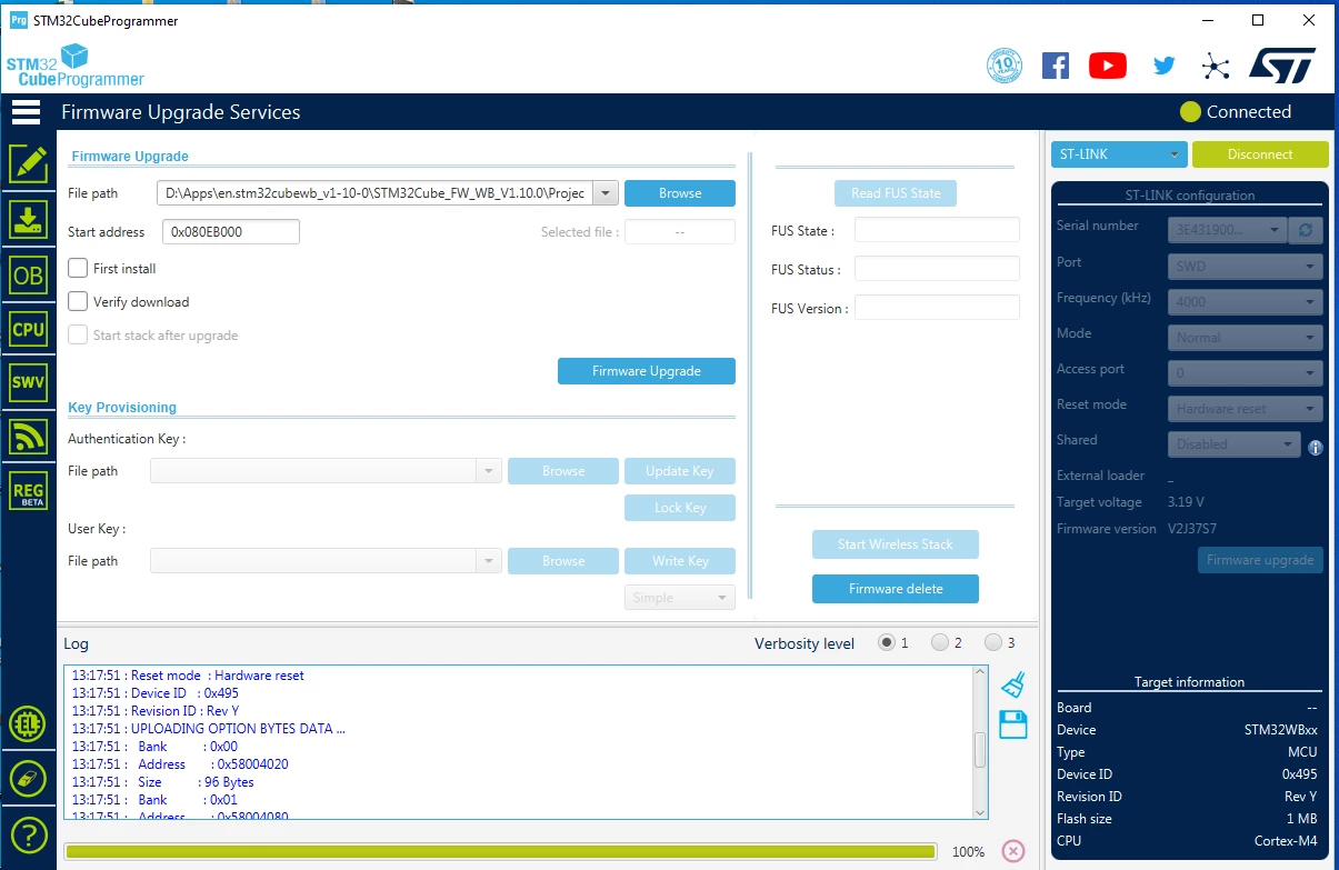

I also checked my board in STM32CubeProgrammer software. As shown in the image below, I can not read FUS state. Is there a problem with FUS?0693W000007B3k2QAC.png
