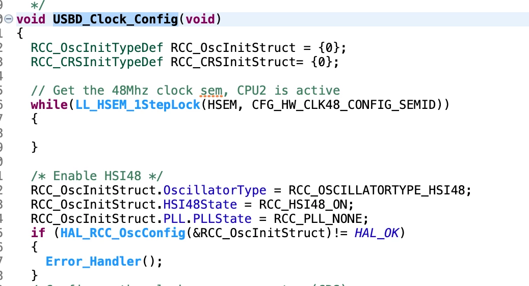

Why can't STM32WB55 USB and BLE work at the same time, using firmware version 1.12.0.

You should poll Sem5 until granted before configuring the clock for USB. See AN5289, figure 9. Else M0 will switch it off.

This was the answer! Thanks!
