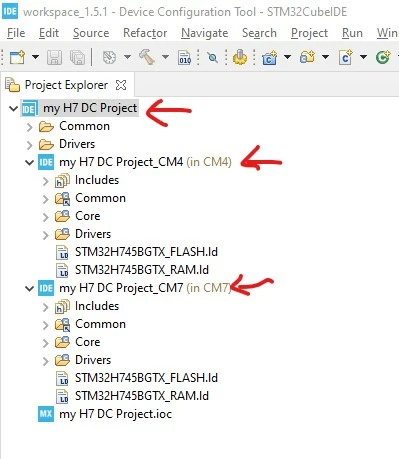

Sounds weird but maybe facing a common Eclipse behavior because playing with some STM32Cube "hierarchical" projects setup.
Please share on which target device are you relying ?
"Hierarchical" projects looks like:
0693W000007DdnzQAC.jpgHere I've "my H7 DC Project" which is my "main" project container.
But takes care x2 other projects are promoted (appplicative ones) ... one per cpu (here my H7 device is a dual cpu one including x1 Cortex M4 plus x1 Cortex M7)
Closing one of them is not closing others ... you have to close all by yourself.

You are right. I only close the top project and not the subordinate projects.
Nevertheless, if I close the top project, the others below it with the other cores should also close, right?
I'm using STM32WLxx
-> Bug in STM32MX 1.5.1 ?

" if I close the top project, the others below it with the other cores should also close, right?" ... from common Eclipse behavior answer is: no.
Eclipse is not managing by itself action propagation thru a "hierarchical" project structure.
So if STM32CubeIDE i would not say bug but we may ask for feature request. Please rely on "Idea Zone" to promote it I guess.

Hello Frank!
This is not really a bug but more due to Eclipse common behavior. Although I can understand from a user experience you wouldn't want it to be like that. However, it is part of our scope to improve this and other functions related to hierarchical projects (such as renaming, copy etc.) but it's not part of the next release.
