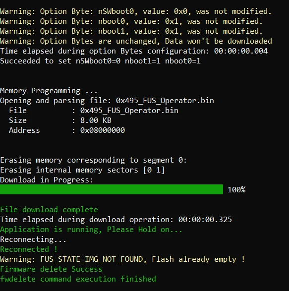

1.Delete the existing wireless stack:
STM32_Programmer_CLI.exe -c port=swd mode=UR –fwdelete
Result:

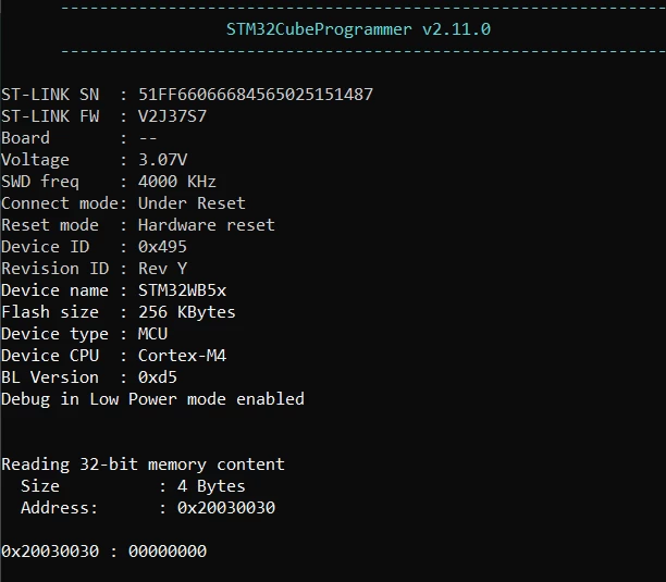

STM32_Programmer_CLI.exe -c port=swd mode=UR -r32 0x20030030 1
Result:

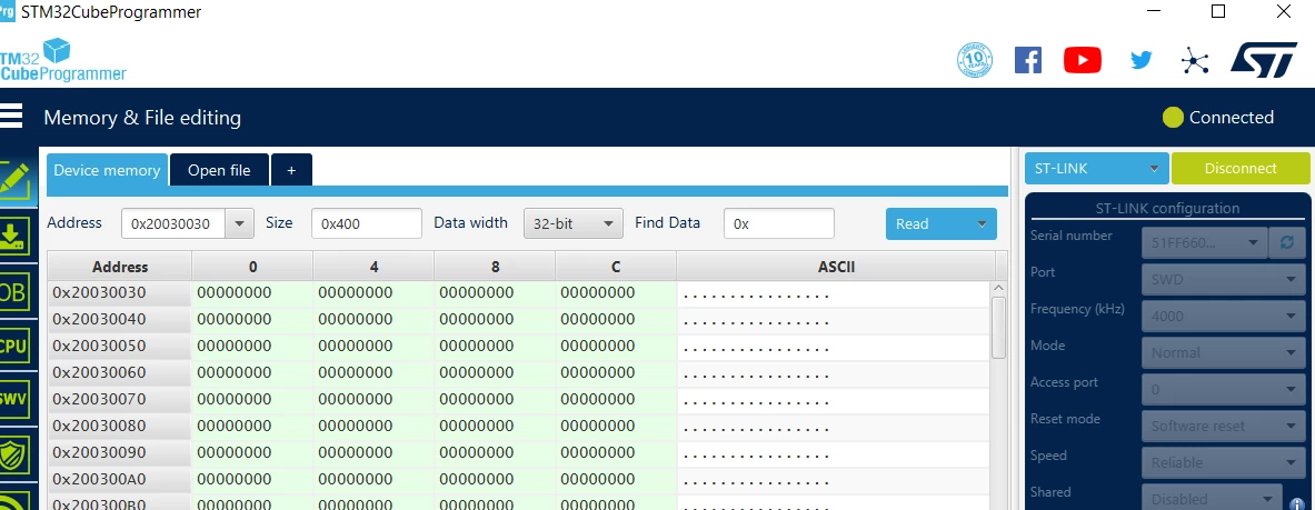

0693W00000QLE4hQAH.png To ensure this, I've checked the address 0x20030030 with STM32Cube Programmer, it is 00000000.
My question is why after fwdelete I got -> 0x20030030 : 00000000 ?

I think that even before deleting the wireless stack, reading the value at address 0x20030030 would give you 0. When using the SWD port, the FUS version is not located at this address. This works in DFU mode.
I would recommend to use the latest CubeProgrammer version which manages to properly read the FUS version whatever the debug port used (USB or SWD).

You can look this wiki page for more information on the FUS. In order to read FUS version, you can also connect your board using ST LINK by following these steps:
  • Connect under Hot Plug mode
  • Start FUS
  • Disconnect
  • Reconnect under Hot Plug mode
  • Read memory
