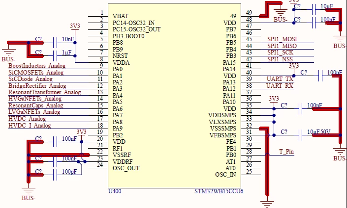

Which pins are available for SPI and UART communication in STM32WB15CC?
0693W00000WJpUrQAL.pngHi team,
I used STM32WB15CCU6 in my project for Voltage and sensing. I already used all analog pin for sensing.
I need one SPI and one UART communications channels.
Can you please suggest which pins can I used for SPI and UART.
I request please share the schematic or pin mapping details.
Thanks & Regards

RChau.7
RChau.7Author
Nov 30, 2022 9:16 AM UTC
Ok.
Can you please give me some idea which pin I can use for SPI and UART.
RChau.7
RChau.7Author
Nov 30, 2022 10:57 AM UTC
Can I use Pin 46 (TX) and Pin 47 (RX) for UART Communication.
RChau.7
RChau.7Author
Nov 30, 2022 12:09 PM UTC
I have used below configurations for SPI and UART communications.
Can you please let me this is ok or not.
For SPI
Pin42- PA15 SPI1- NSS
Pin43- PB3 SPI1- SCK
Pin44- PB4 SPI1- MISO
Pin45- PB5 SPI1- MOSI
For UART
Pin46- PB6 USART1_TX
Pin47- PB7 USART1_RX
I request please provide your opinion.
Thanks
Remy ISSALYS
Nov 30, 2022 1:25 PM UTC
Yes, you can use these pins.
