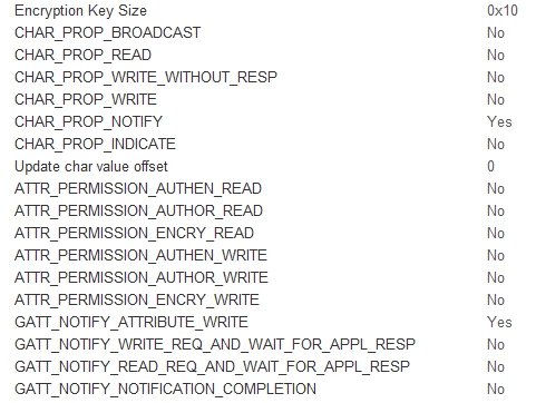

Which characteristic should be selected for data reception?
I am working with the ble_p2pServer_ota example with an STM32WBA55 controller.
If I want to send data (one byte for example) to an app on a cell phone, what settings do I have to make in the characteristics in CubeMX?

Hello @ledi001
To do what you are looking for, you have to use Char Prop Notify.
Best Regards.
