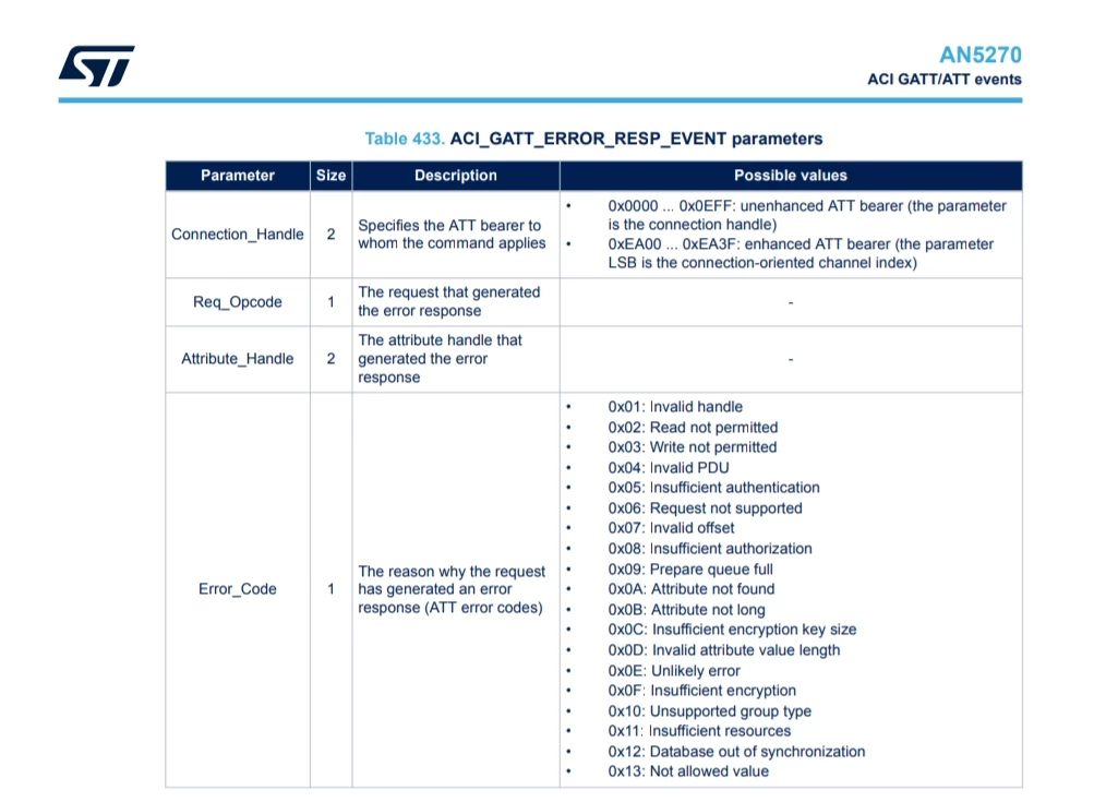

Where is the list of Req_opcodes for Gatt_Error event
Hello
I am getting: error on opcode 0x08 what is it?
Opcodes not listed in document.
See here:
Table 433. ACI_GATT_ERROR_RESP_EVENT parameters
Parameter Size Description Possible values
Connection_Handle 2
Specifies the ATT bearer to
whom the command applies
• 0x0000 ... 0x0EFF: unenhanced ATT bearer (the parameter
is the connection handle)
• 0xEA00 ... 0xEA3F: enhanced ATT bearer (the parameter
LSB is the connection-oriented channel index)
Req_Opcode 1
The request that generated
the error response -

Hello @DS.4
from what I understood of your explanation, I think you are looking for more details about the ACI_GATT_ERROR_RESP_EVENT event. I suggest you to take a look at the part 3.4.16 of the AN5270:
If that doesn't answer your question, i suggest you give more details about your request.
Best Regards.
