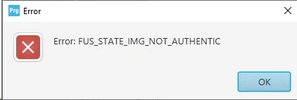

Where can I find FUS binary file with FUS version 1.0.2?
I just got my STM32WB55 Nucleo boards with FUS v.0.5.3 and trying to upgrade firmware but neither of the provided .bin files in "repository" ("stm32wb5x_FUS_fw.bin" or "stm32wb5x_FUS_fw_for_fus_0_5_3.bin") work. I get the same message for both when trying to program the files using STM32CubeProgrammer tool. (Note: message "Firmware Delete Successful" was present).
Attaching a picture of the error message I get.
Note: I tried to accomplish the same thing using both user USB DFU and ST-LINK interfaces.
Here's log from my flash attempts:

10:45:12 : Error: FUS_STATE_IMG_NOT_AUTHENTIC

Oct 1, 2021 1:58 PM UTC
Hello @AOris.1​,
It maybe the error caused by the previous FW installation.
Make sure to perform a partial mass erase of the flash memory and ensure a clean memory before any programming.

AOris.1
AOris.1Author
Oct 1, 2021 2:06 PM UTC
Imen,
Thank you for the response but I must say that I have already tried that and yet still same error.​
Imen.DBest answer
Oct 1, 2021 2:13 PM UTC
Try setting RDP option byte to 0xBB and then back to 0xAA.
Then try to upgrade the FUS once again.
Hope this helps you !
AOris.1
AOris.1Author
Oct 4, 2021 3:15 PM UTC
Imen,
IT WORKED!!!!!!!!!!!!!!!!!!!!! Thank you!!!!

11:05:04 : Warning: Option Bytes are unchanged, Data won't be downloaded
11:05:04 : Succeeded to set nSWboot0=0 nboot1=1 nboot0=1
11:05:04 : Memory Programming ...
11:05:04 : Opening and parsing file: 0x495_FUS_Operator.bin
11:05:04 :  File         : 0x495_FUS_Operator.bin
11:05:04 :  Size         : 8 KBytes
11:05:04 :  Address      : 0x08000000
11:05:04 : Erasing memory corresponding to segment 0:
11:05:04 : Erasing internal memory sectors [0 1]
11:05:04 : Download in Progress:
11:05:04 : File download complete
11:05:04 : Time elapsed during download operation: 00:00:00.289
11:05:04 : Application is running, Please Hold on...
11:05:11 : Reconnecting...
11:05:11 : Reconnected !
11:05:11 : Warning: FUS_STATE_IMG_NOT_FOUND, Flash already empty !
11:05:13 : Firmware delete Success
11:05:13 : Download Stack/FUS image at address 0x803a000 ...
11:05:13 : Memory Programming ...
11:05:13 : Opening and parsing file: stm32wb5x_FUS_fw_for_fus_0_5_3.bin
11:05:13 :  File         : stm32wb5x_FUS_fw_for_fus_0_5_3.bin
11:05:13 :  Size         : 24492 Bytes
11:05:13 :  Address      : 0x0803A000
11:05:13 : Erasing memory corresponding to segment 0:
11:05:13 : Erasing internal memory sectors [58 63]
11:05:13 : Download in Progress:
11:05:13 : File download complete
11:05:13 : Time elapsed during download operation: 00:00:00.655
11:05:13 : Firmware Upgrade process started ...
11:05:13 : Application is running, Please Hold on...
11:05:25 : Reconnecting...
11:05:25 : Reconnected !
11:05:25 : Error: FUS_STATE_IMG_NOT_AUTHENTIC
