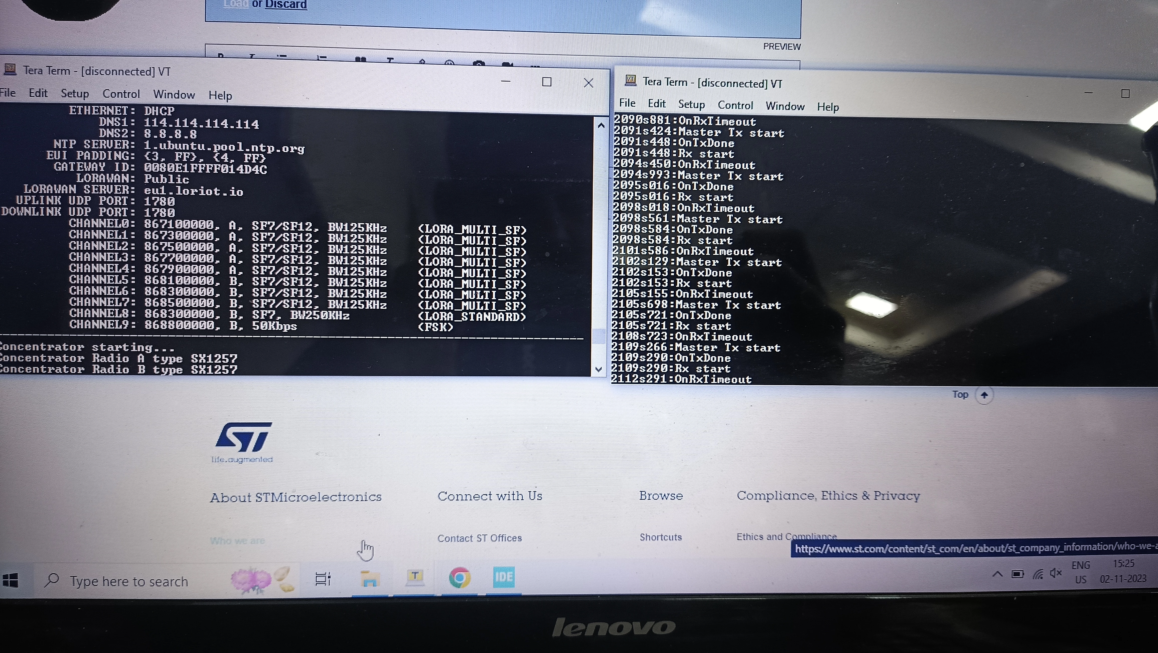

YuviAuthor
Nov 1, 2023 11:20 AM UTC
@Tinnagit
When we set gateway according to the region and display it using terminal(Tera Term) we can we for India terminal show FSK : OFF.IMG_20231101_165015.jpg
And if we set gateway to European region then gateway show FSK : 50 kbps. ( terminal photo for europe )
Tinnagit
Senior II
Nov 1, 2023 12:09 PM UTC
Is this your own gateway?
As I had told that sx127X is support FSK and most gateway have this feature also my region but the FSK Modulation is not LoraWan so this feature was disabled usually.
But if it's your own and you can config your gateway so you can enable this feature.
YuviAuthor
Nov 1, 2023 11:22 AM UTC
@Tinnagit
On this basis I'm able to say that europe support FSK and not India.

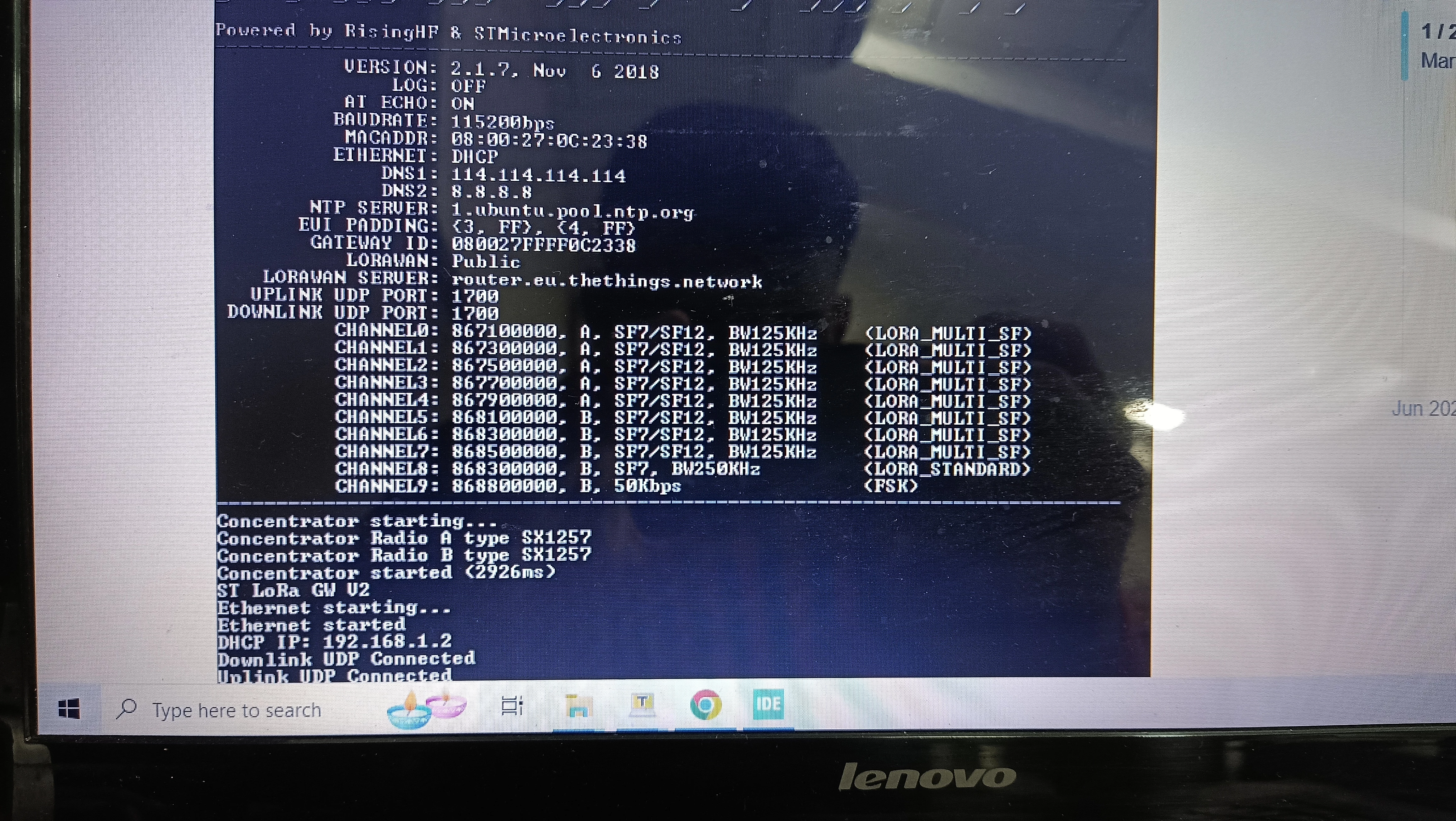

YuviAuthor
Nov 2, 2023 10:00 AM UTC
Hello @Tinnagit  @AScha.3  @Tesla DeLorean
As gateway terminal image shows FSK at channel 9 and 868 frequency.
As I downloaded the library code the default set region is Europe and frequency is 868.
And I have made these changes #define USE_MODEM_LORA 1
#define USE_MODEM_FSK 0
to
#define USE_MODEM_LORA 0
#define USE_MODEM_FSK 1
However, the gateway and node are not getting connected.
Thank you.
Tinnagit
Senior II
Nov 3, 2023 7:16 AM UTC
you have to config Bandwidth Baud rate and Channel to match with your gateway too.
