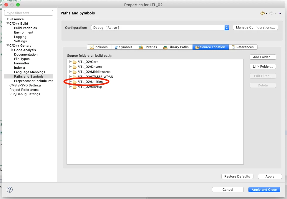

XavierV.Best answer
Dec 10, 2019 3:42 PM UTC
I had the same issue. To resolve it, I have added "Utilities" path in C/C++ General->Path and Symbols->Source Location. Because if you read the complete log, you can see compiler never reads this folder.
This issue exists if you use the standalone CubeMX or the integrated CubeMX wizard in CubeIDE.

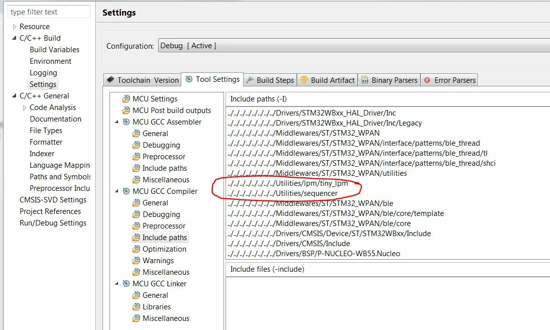

Remi QUINTIN
Dec 9, 2019 4:47 PM UTC
​I think there is a few paths missing in your compiler settings to point on STM32Cube_FW_WB_V1.3.0\Utilities\sequencer and lpm.
see attached picture.
These include paths are not automatically inserted when the project is generate from CubeMX.

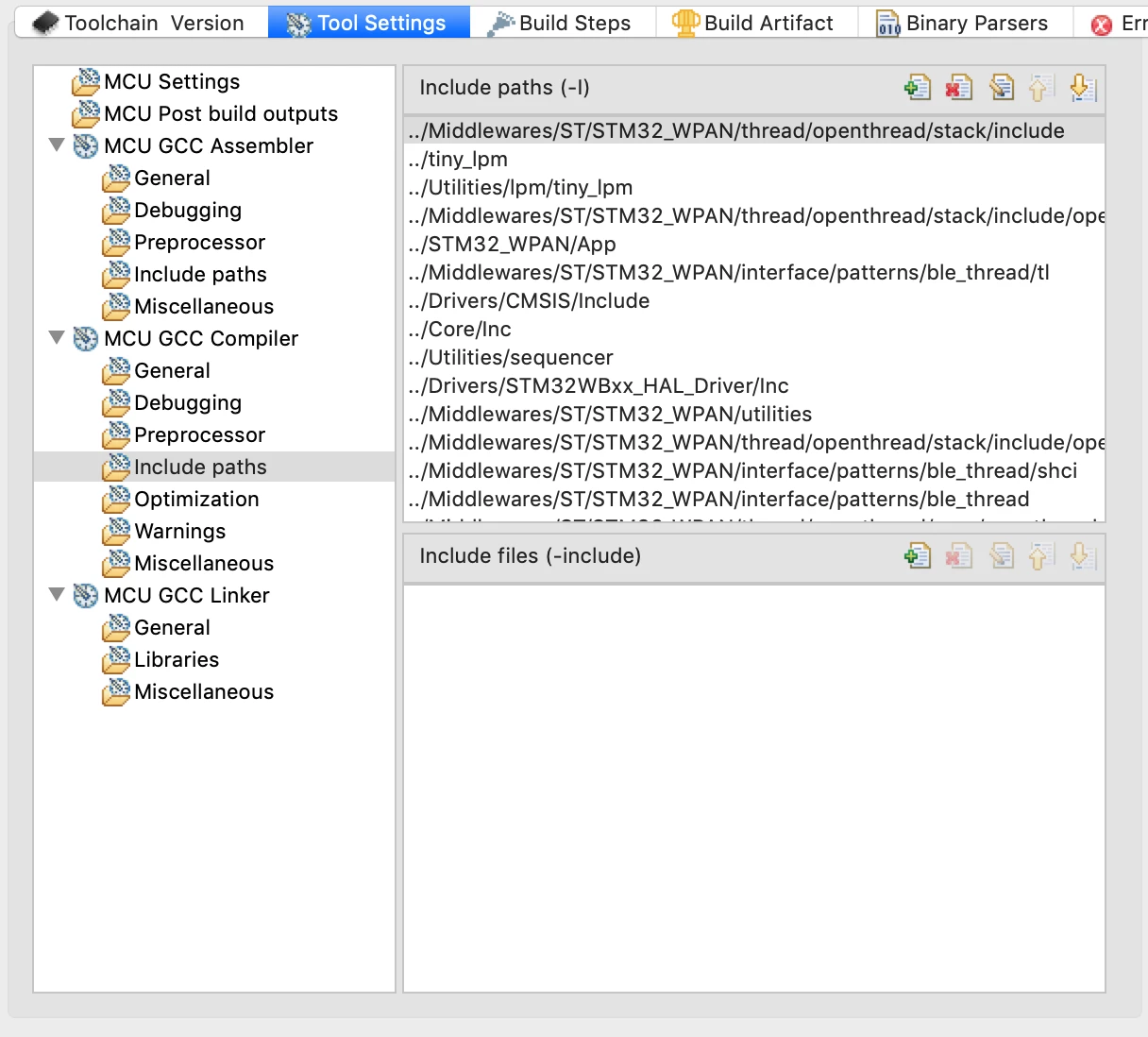

NGama
NGamaAuthor
Dec 9, 2019 6:12 PM UTC
I thought this was the problem as well, but I had checked the include and all of them were there, I have added a screenshot below. Do you think there might be some problem with my configuration?0690X00000AtT6hQAF.png I have added a mx report as well
Remi QUINTIN
Dec 10, 2019 10:51 AM UTC
Strange to see ../tiny_lpm here as it is not the right path. The correct path is the one just below it. This may create a conflict.

NGama
NGamaAuthor
Dec 10, 2019 4:00 PM UTC
Thank you so much, this fixed the problem! I have been trying to solve this for a while now.
