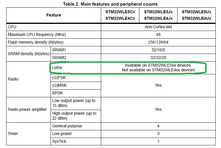

What is difference between STM32WLE5CC and STM32WLE4CC? It looks like they are both M4, single core, same stats etc.

No LoRa on LE4, less cost/licensing..

thank you. Do you have a link for this table?
