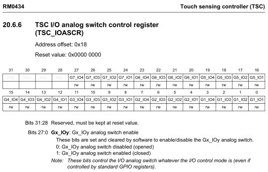

What does TSC_IOASCR do?
What does the TSC_IOASCR register do?
Checked the reference manuals for STM32 WB35xx/WB55xx (RM0434) and F0xx (RM0091) and only get the following information:
What's the behaviour of this setting for pins in the various modes (unused, sampling, channel)? I see that it says "Note: These bits control the I/O analog switch whatever the I/O control mode is (even if controlled by standard GPIO registers)." but what does controlling the analog switch mean and how does it relate to TSC?

Hello DK.6,
You can find more information about the TSC for the WB here:
https://www.st.com/content/ccc/resource/training/technical/product_training/group0/cb/25/df/48/a9/6b/45/89/STM32WB-Peripheral-Touch-Sensing-Controller-TSC/files/STM32WB-Peripheral-Touch-Sensing-Controller-TSC.pdf/_jcr_content/translations/en.STM32WB-Peripheral-Touch-Sensing-Controller-TSC.pdf
It shows what the analog switch (controlled by TSC_IOASCR ) is and what it's used for.
Regards,
Stassen
