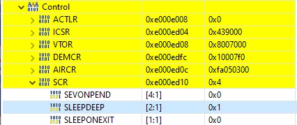

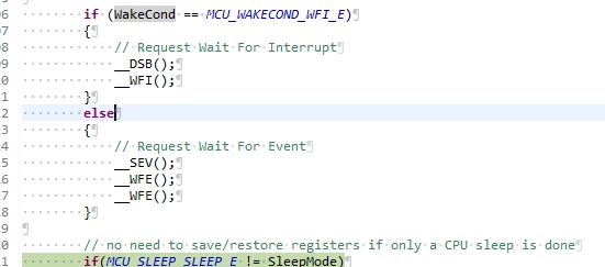

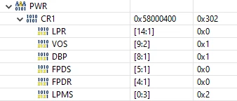

What can prevent entering STOP mode? (STM32WB)

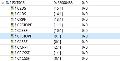

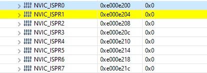

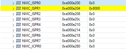

After some activity using BLE in the background and UART as well as some EXTI on application side, the consumption jumps from 2,4µA to 4mA, so obviously I have a wakelock. If I hotplug to the system afterwards, I can see in PWR_EXTSCR that Stop mode is no longer actually reached (C1STOPF is not set). But checking ISPR I can not see any pending ISRS (the one after Stop is the LPTIM of my OS).
What else can prevent the CPU from entering stop? Which registers should I check?
