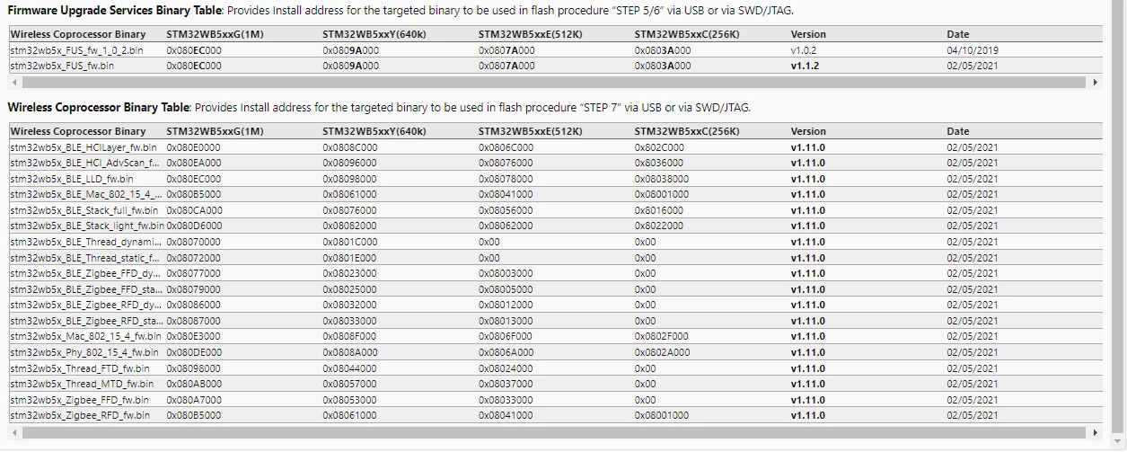

What are the flash memory sizes for the STM32WB coprocessor binaries?

Does anyone know if there is a table or some reference which shows how many bytes each binary will consume on the target STM32WB's Flash memory?

You can either have a look in the WB package at the size of each file or you can compute it from the table above knowing that the load address is considering the wireless stack is below the FUS area starting from 0x80F4000.
