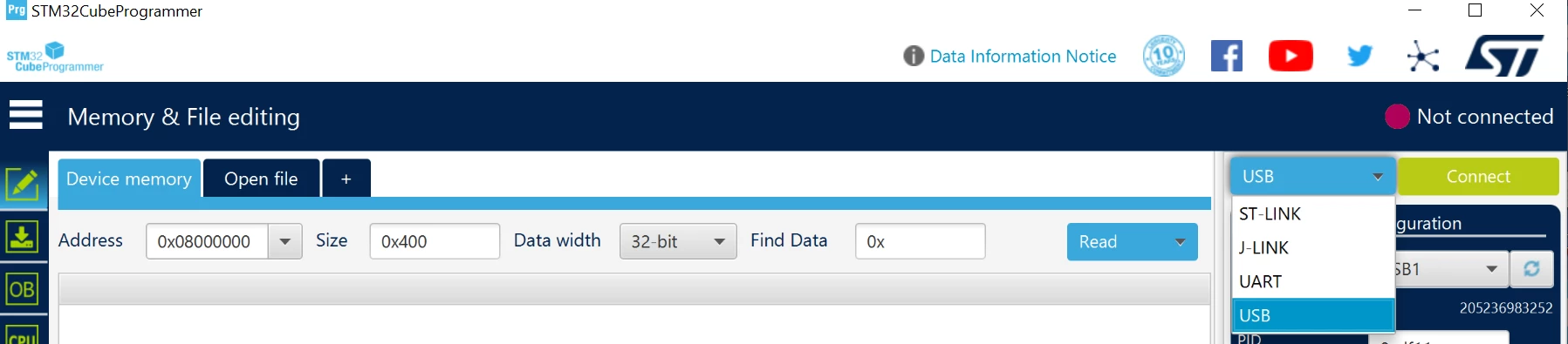

Hello
I have tried to update the FUS, BLE Stack, and the default client app on the dongle.
I have now done this several times, with the Clent App not doing what the UM says.
But the issue now is that the USB Dongle in Boot0 mode is not seen by windows (--> Cube Programmer).
If I move the switch to std mode, no difference. Only the green LED lights on the dongle.
Have I bricked the device? or is there a process to bring it back.
Thank you.
Giri

Hello @GRama.2
Have you verified that the BOOT0 switcher SW2 is set to 1 and connect to the Cube Programmer using the USB mode:
The dongle can be connected and programmed only using the USB mode (No embedded ST-LINK on the Dongle).
Best Regards.

Yes, I have verified SW2 is set to 1.

SW2 was/is 1

Are you cinnecting under USB or DT-Link.

Connected via USB using CubeProgrammer v2.16.0
