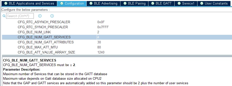

I am trying to follow the "STM32WB Getting started Series: Part 12b lab..."(https://www.youtube.com/watch?v=CKYWy7LKL68&list=PLnMKNibPkDnG9JRe2fbOOpVpWY7E4WbJ-&index=16) on youtube.
In the video he is using a WB55, but I am trying to implement it on a WB15 (both Nucleo).
But, it does not work on the WB15 board. When I try it on the WB55 board, it works fine.
I have been combing through the video trying to see if I have a setting somewhere that is different, but nothing jumps out.
If I open up the P2P example project from CubeMX, it works just fine, so the BLE stack is working fine on the WB15 board.
I am hoping there is just some setting I am missing, because the project will eventually have to run on a costum board with a WB10 :\

So, I think I found out what was wrong.
In the BLE configuration tab the following 4 parameters seemed to be too large for the WB15 (and WB10)
CFG_BLE_NUM_GATT_SERVICES 8
CFG_BLE_NUM_GATT_ATTRIBUTES 68
CFG_BLE_MAX_ATT_MTU 156
CFG_BLE_ATT_VALUE_ARRAY_SIZE 1344
If I set them to the below values it seems to work just fine. I have no reason for setting them to these exact values, it was just less than the original values :|
It says in the description area that the size depends and the GATT database size in CPU2, but I have not been able to find the size definition of this database anywhere...

You can find some information about this in application note AN5289. A wiki page on this topic is under redaction.
