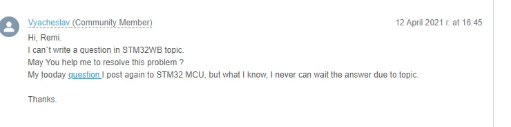

2 years ago it happened that the controller turned to brick. I corresponded with technical support for a long time and I was offered to send the controller to the factory or representative. But since the case was a single one, I did not take advantage of this case and forgot about it.

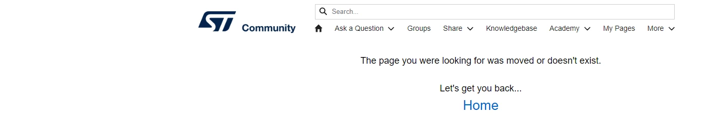

The reason is well described in the post:
https://community.st.com/s/feed/0D53W000010si7oSAA?t=1676280731376
But for all this time, not a single STM employee has given a clear explanation of why this is happening.
The question is simple: why sometimes, after loading the stack, the chip register SFSA = 0?
After all, because of this, the chip turns into a brick.

Is it possible that this is your old thread?
Please keep in mind, that the community is a place for questions where users can benefit from the experiences of other users. Now that @Remi QUINTIN​ has helped you before, perhaps he will be so kind again?

Feb 13, 2023 3:24 PM UTC
Thanks for the quick response.
But this is not the thread.
By the way, the problem was not solved in the specified thread either, so we still use the version of SDK 1.11 in the old device only because of the indicated problem.
And the thread about which I spoke, where the states of the register were indicated many times - it does not exist.
