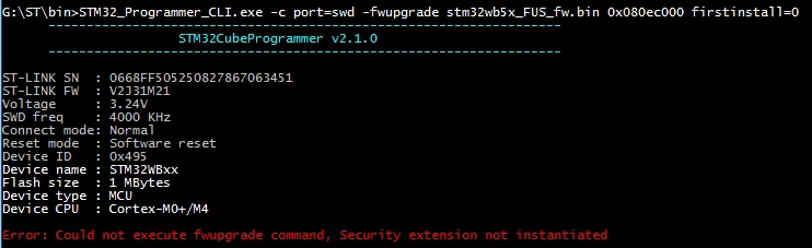

I'm trying to flash the FUS and BLE_stack to the co-processor, but the CubeProgrammer drops me the error below. I could not even delete the previous FUS as the release note said. Same error message. The flash was erased by changing the protection byte to 0xBB and then back to 0xAA. Could that be my problem? The MCU is on a custom PCB, and the important parts are the same as on the WB55-Nucleo and I'm using a nucleo with s-link to program through SWD. The application runs perfectly on the M4 (except the bluetooth part).
So the error message is: "Error: Could not execute fwupgrade command, Security extension not instantiated".
Any help is appreciated.

​>The flash was erased by changing the protection byte to 0xBB and then back to 0xAA.
No this just erases the non -secure part of the Flash memory.
The issue is more on the SWD side. This interface does not support the upgrade process of the secure part completely. For example the upgrade commands are not supported. They will be supported in the next version of the FUS operator that should available very soon (a few weeks).
So for now we recommend to use either the UART or the USB-DFU interface.
The next version of the upgrade tool using the Debug (STLINK/SWD) Interface  will support the full upgrade process even with one single command.
Here is an example for FUS/Stack upgrade through SWD with the new version:
  •  FUS Upgrade :
STM32_Programmer_CLI.exe -c port=swd mode=UR -ob nSWboot0=0 nboot1=1 nboot0=1 -fwupgrade stm32wb5x_FUS_fw.bin 0x080EC000 firstinstall=1
  • Stack install :
STM32_Programmer_CLI.exe -c port=swd mode=UR -ob nSWboot0=0 nboot1=1 nboot0=1 -fwupgrade stm32wb5x_BLE_Stack_fw.bin 0x080EC000
  • User application install :
STM32_Programmer_CLI.exe -c port=swd mode=UR -d UserApplication.bin 0x08000000 -v
All these operations can be combined in one command :
  • STM32_Programmer_CLI.exe -c port=swd mode=UR -ob nSWboot0=0 nboot1=1 nboot0=1 -fwupgrade stm32wb5x_FUS_fw.bin 0x080EC000 firstinstall=1 -c port=swd mode=UR -fwupgrade stm32wb5x_BLE_Stack_fw.bin 0x080EC000 -c port=swd mode=UR -d UserApplication.bin 0x08000000 -v

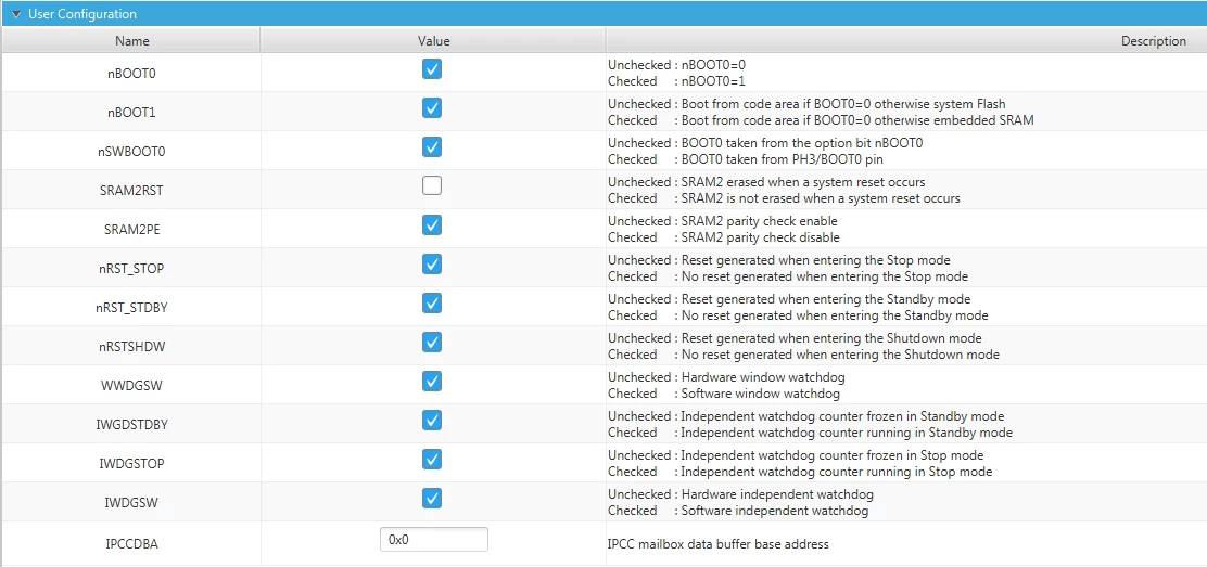

BOOT0 is grounded with a 10k as it supposed to be. I debug it through SWD using ST-Link. The application runs well, I can blink LEDs and stuff, but it seems, the sequencer doesn't initializes the BLE.
MLeng.638
MLeng.638Author
October 16, 2019
@Remi QUINTIN​
And here are the option bytes, I assume these are default values.

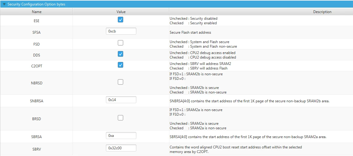

​In fact I would like to see the secure option bytes: ESE, SFSA, SBRV, C2OPT, ...
MLeng.638
MLeng.638Author
October 16, 2019
@Remi QUINTIN​
