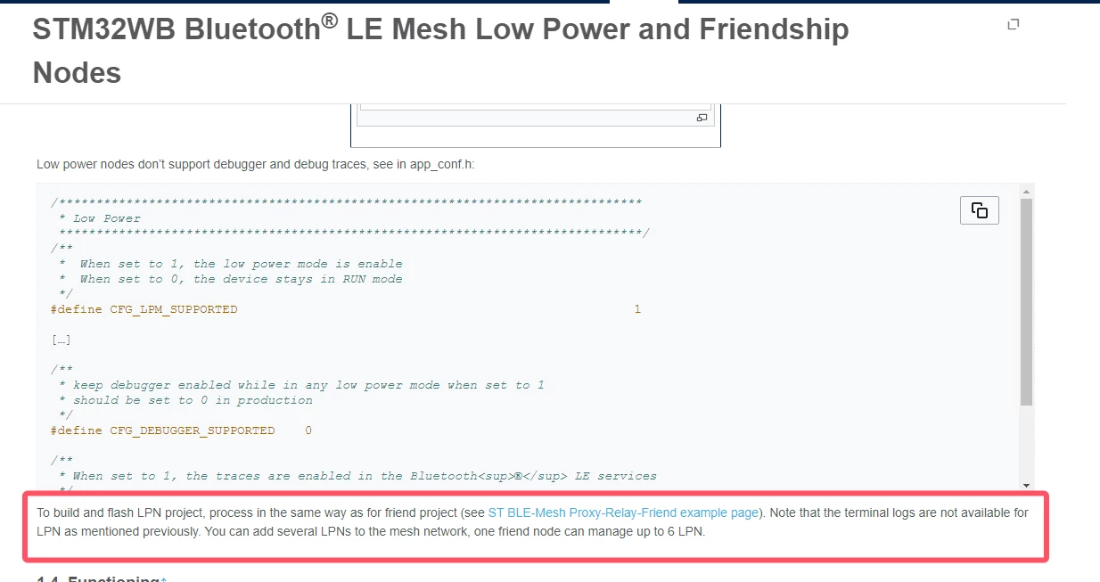

WB55: A friend node can connect up to 6 LPNs at most
The correspondence between friend nodes and LPNs in the ST official website description states that a friend node can connect up to 6 LPNs at most. Other chips can connect more LPN nodes with one friend node. Has ST optimized in this area?

Hello @DL_Weng
The LPN/friend association is limited by the 1KB SRAM available and the Radio Time that it take. That’s why is recomanded to Connect a maximum of 6 LPN to the same end friend node.
Best Regards.
