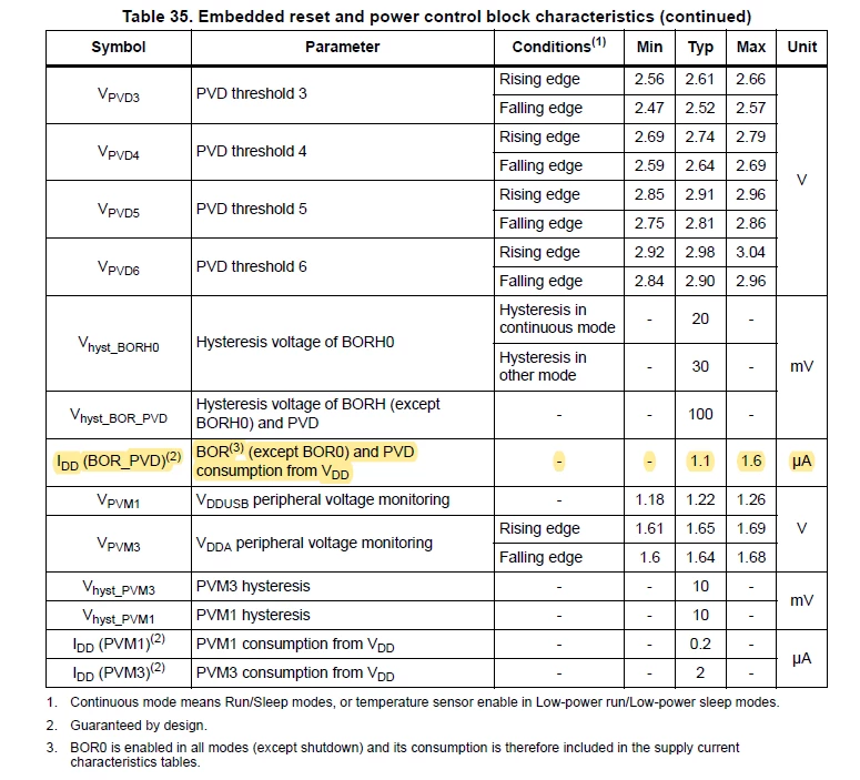

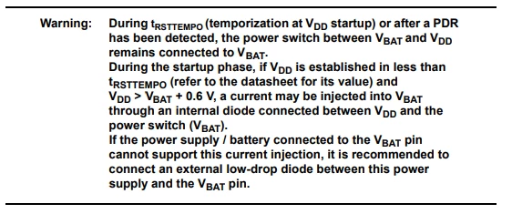

Also, about this warning in RM0434 application note, what is the value of this current? Is it equal to value of the current (IDD (BOR_PVD)) that I colored in yellow in the table in second picture?0693W00000WHvwnQAD.png0693W00000WHvwsQAD.png

use 3,3V VDD ? then need nothing, because vdd - 0,6 = 2,7 . so injection may be, if batt is 2,7 or lower - and that is empty/dead batt anyway.
just use ch18 only for test and switch off after testing, otherwise you kill batt by permanent test current.
