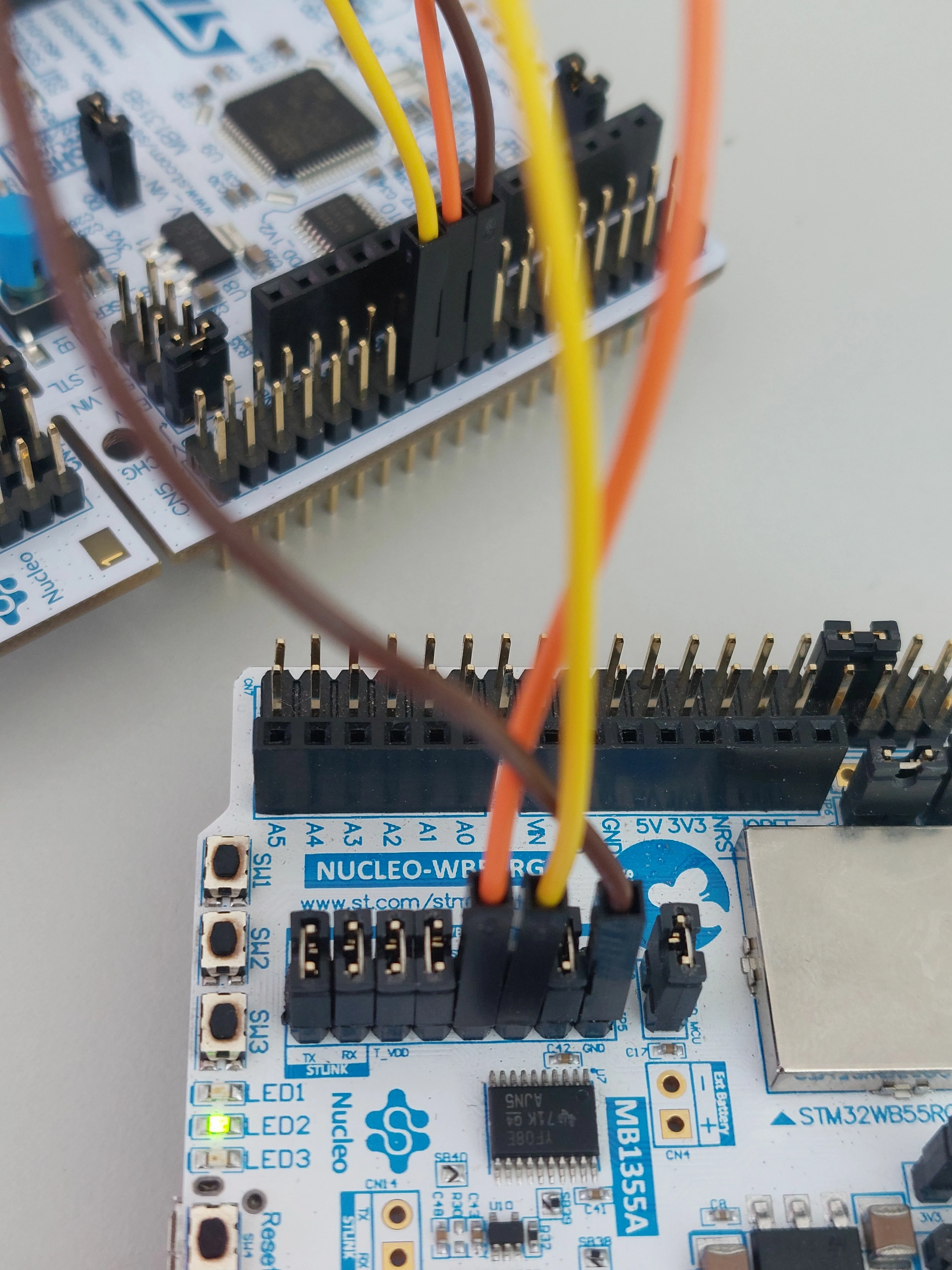

Hello! On the board STM32WB55RGV6 there is the connector CN13, where is written STLINK (reserved). Can I use these pins to program another board?

Just tested, it is working fine with STM32CubeProgrammer. I connected an MB1355 to an MB1319 (STM32L452) with 3 wires only.
MB1319 ST-LINK is kept under reset to allow using MB1355 one.

No, as you wrote, CN13 is a "reserved" connector, so please avoid touching it.
Use JP5 and remove appropriate jumpers to get the SWDIO/SWDCLK/GND signals and plug them to another target. Should work.

@Mike_ST​ Keil uVision cannot find the target (SWDIO: no target connected) . The target is an usb dongle

More details...
You'll need to pick the ST-LINK and the target.
Make sure the jumpers are in place to connect the on-board ST-LINK to the internal target.
Perhaps also try to validate connectivity using STM32 Cube Programmer.
Current version of Keil, most up to date ST-LINK .DLL's etc?

@Mike_ST​ I see that you put a jumper between VDD and BOOT0. Did you put a jumper somewhere else on the MB1355 ?

This BOOT0 jumper is not important as the ST-LINK probe on the MB1355 is disconnected from the STM32WB55.
I haven't done anything else.

Thank you @Community member​  and @Mike_ST​ ! I did exactly as @Mike_ST​ did on the photo above and it now works. I had to put put all jumpers correctly.
