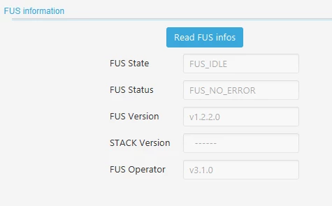

If I understand you correctly, this means programming the "BRSD_A" and "BRSD_B" bits with STM32CubeProgrammer should work under section "Security Configuration Option bytes", as long as there is no wireless stack in the flash. In addition to that, I erased the flash so that there is no application firmware present.
Reading the FUS information under section "Firmware Upgrade Service" gives the following result:
_legacyfs_online_stmicro_images_0693W00000bVgMsQAK.png(I also have a custom board with a STM32WB5MMG where I deleted the previously loaded wireless stack. The STACK version display shows "v0.0.0.0".)
Trying to modify the option bytes with STM32CubeProgrammer yields the following result:

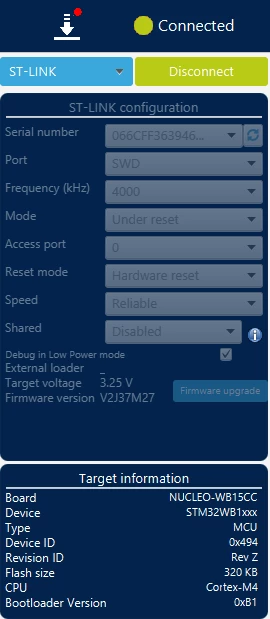

Just in case this could be a potential problem, here is information on my setup:

After deleting the wireless stack once again on the Nucleo-WB15, the shown STACK-version remains "------", but now SRAM2a is unsecured. Although having access to SRAM2b would be nice, I think the combined size of SRAM1 (12KB) and SRAM2a (32KB) will be sufficient.
