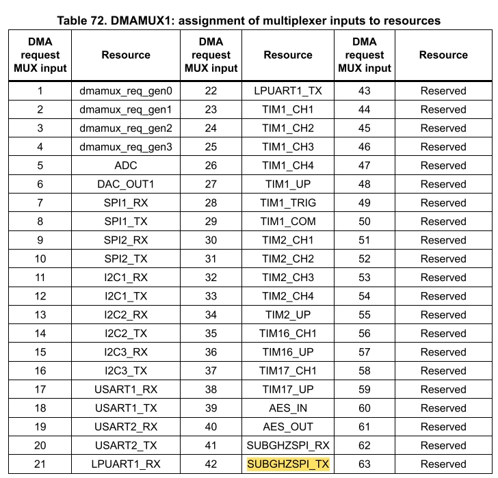

After reading all documents about the STM32WL55 and STM32WLE concerning the SubGhz and DMA, I don't find how can I use the DMA and DMAMUX with SUBGHZSPI_TX.

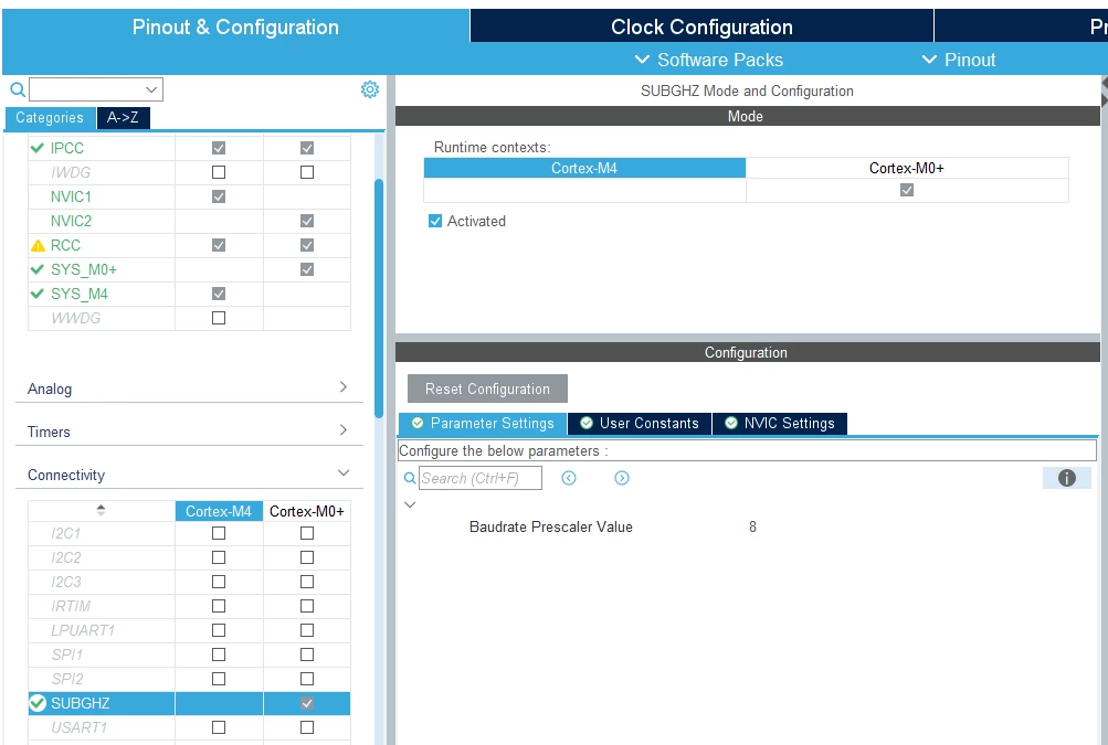

In fact, on the board NUCLEO-WL55JC1, I would like to send  as fast as possible a short message trough the Subghz (LoRa) when the button 1 is pressed. So I think the best way is to use the DMA : the button pressed is the trigger, and using the DMA in memory-to-peripheral, in other words, send 3 bytes from memory (0x83 for Opcode of SetTx, 0x000000 for the timeou) to SUBGHZ module via spi interface.
My analysis :
According the RM0461, the table 72 list the assignement of multiplexer inputs to resources. At 47 DMA request MUX input, they is SUBGHZSPI_TX :

So I used the Ping-Pong example project.
Even if the SubGhz module activate, I don't find any DMA or DMAMUX tab !
And in DMA in "System Core", I wanted to add a DMA with "Request generation Signal" is SUBGHZSPI_TX but nothing in the list !
So, can someone help me?
Where can I find an example project to use the SUBGHZSPI_TX with DMAMUX ?
Thank you.

Hello @SamirDB
For now, there is not any possibility to use the SUBGHZSPI module with DMA. you should use the bare metal implementation included on the SubGHZ/Lora Middleware.
Best Regards.
