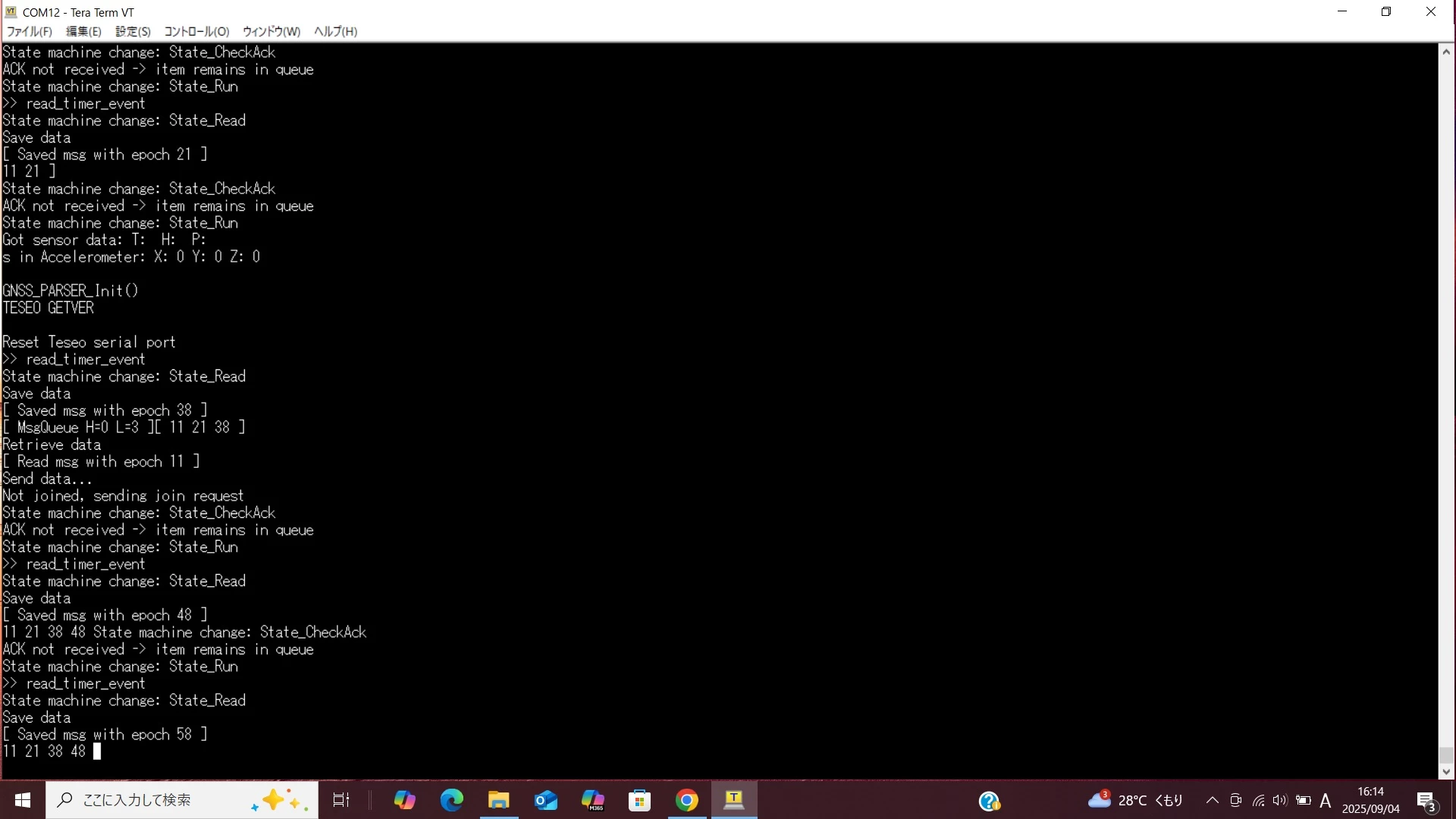

I deleted some of sensor related codes. Teraterm showed following message. What does it mean? I think there are still errors remaining.
Andrew Neil
September 4, 2025
It would be easier to read posting as text rather than a screenshot.
(To post formatted text, see this)
Again, search the source code for those messages to see what causes them to be emitted.
"Not joined" sounds like issues with joining the LoRaWAN network ?
