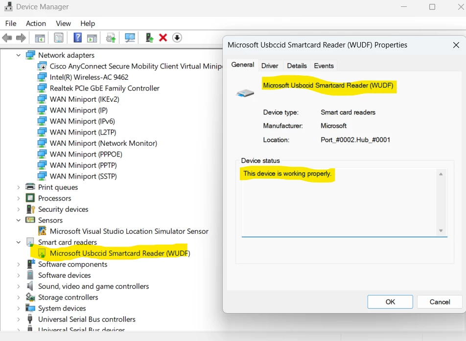

Following the integration, I successfully configured the USB device, and my system(windows PC) can now detect the STM32WB MCU as a smart card reader.
However, upon further testing, I encountered an unexpected behavior: when attempting to communicate with the smart card reader using a Python script, the STM32WB USB port is detected as a Virtual COM port rather than a smart card reader. As a result, I am unable to establish communication with the MCU via script.
I am reaching out to kindly request your assistance in resolving this issue. Could you please provide guidance or solutions to ensure that the STM32WB MCU is correctly detected as a smart card reader and able to communicate with application?

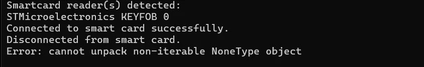

I just wanted to give you and update that on python script my device able to detect as smart card reader but after that no communication happen. I'm sharing the python script here which I used for my testing.

 After run the script I received the response of connected to smart card and name is also correct. But after that no data received on STM32WB55 MCU configured as smart card reader.
"Error: cannot unpack non-iterable NoneType object" is occurred because no response received from device.
I'm confused because on connection request and transmit data no event generated on MCU.
Can you please suggest where I'm doing wrong ? CCID is new for me so not having much information about it.
Any support you provide will really helpful to me.
