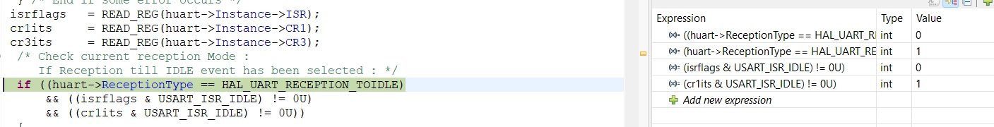

LPUART could wake up MCU that I verifed by set a break point on
void LPUART1_IRQHandler(void)
But USART_ISR_WUF is not set causing I can't handle RX message after resuming from STOP2 mode, is there anything I missed?

Dec 20, 2024 3:28 PM UTC
Hello @Charles_Li @Roger SHIVELY
I have exactly the same problem,
The frame is processed only when the MCU exits STOP2 mode.
I have the impression that the problem comes from the LPUART==>ISR==> IDLE bit which seems hardware and takes a while to go from 0 to 1.
I added a small delay right after the interrupt and everything works perfectly, but I don't think it's the best solution.
Very roughly, I tried a while loop
while (LL_LPUART_IsActiveFlag_IDLE(LPUART1) == 0)
This allowed me to understand that the problem was indeed coming from the LPUART==>ISR==> IDLE flag which was triggered a little after the IDLE interruption of my DMA.
@Roger SHIVELY  have you a solution?

Dec 23, 2024 12:34 AM UTC
I got expected flags after removing the below lines in PWR_ExitStopMode,
		__HAL_UART_DISABLE_IT(huart,UART_IT_WUF);
		HAL_UARTEx_DisableStopMode(huart);
It goes to WakeupCallback when UART wakes MCU from STOP mode but not RxEventCallback
 /* UART wakeup from Stop mode interrupt occurred ---------------------------*/
 if (((isrflags & USART_ISR_WUF) != 0U) && ((cr3its & USART_CR3_WUFIE) != 0U))
