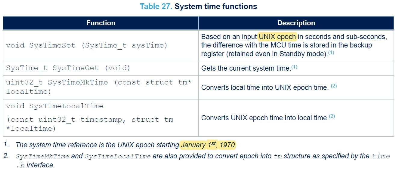

Is there a new "standard" way to handle time other than the original UNIX time was mentioned in AN5406 - Rev 7 - How to build a LoRa® application with STM32CubeWL, which will overflow in year 2038?

On the Current Implementation, we are only using UNIX time as mentioned on the application note.

You can use a different starting epoch, ie not 1970's, but rather Jan 1 2024, or something
You can use 64-bit time
David_Author
Apr 24, 2024 6:53 PM UTC
Many thanks.  I was told that GCC can use 64 bit time by command line option.  Yet to find out how to put in the command line option within the STM32Cube toolchain
"Starting with bookworm, you can compile C using gcc -D_TIME_BITS=64 -D_FILE_OFFSET_BITS=64 to use 64bit time_t"
